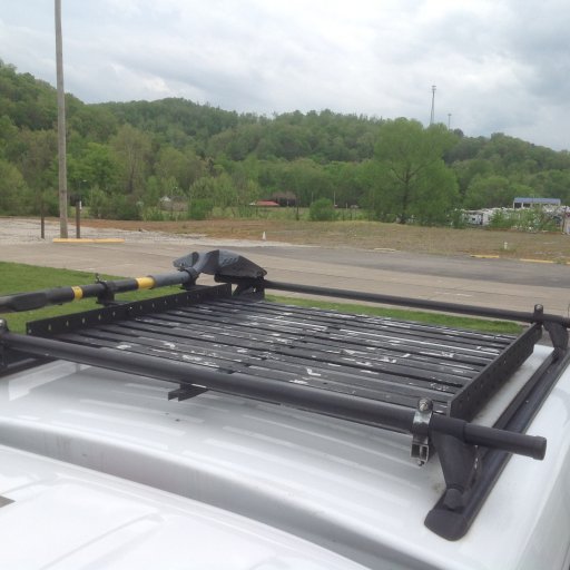

I have an ARE brand CX series topper on my truck with the factory installed Yakima system. I built a very simple aluminum rack that connects to the crossbars with cheap conduit hangers. I mainly used rivets, but there are a few bolts as well. It looks cheap but it works well.
I use mine to haul firewood all the time over gravel/potholed roads at pretty legitimate speeds. I have had ZERO issues with my rack or topper. I have taken my truck all over the state spanning thousands of miles without issues. The roads vary from interstate to rock trails with mud.
I really like the Yakima stuff because it is very modular for my hobbies. I would not hesitate to stack my Yakima homemade rack setup against anything out there.
I have never weighed the firewood on the roof but I would guess around 150 pounds.
I will agree with the others on the price of a topper. I am in to mine approx $1800 and the rack cost me around $80 to build. The ARE topper has a lifetime warranty regarding the shell.
Of course now mine will probably crack open like an egg next trip and make me look stupid.
I will try and grab a picture of my rack in the morning.

Too much rain this morning to get a picture. I will try after work.
