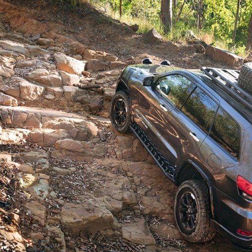

Did you guys see the new sliders that Chief Products are getting ready to release? They are building a wk2 called "HELLHAWK" They will be releasing a new front bumper and the sliders. They have some early photos posted on there web site and there Instagram.

Here's a better shot of the rails, they said they are doing final testing now so they should go in production soon.

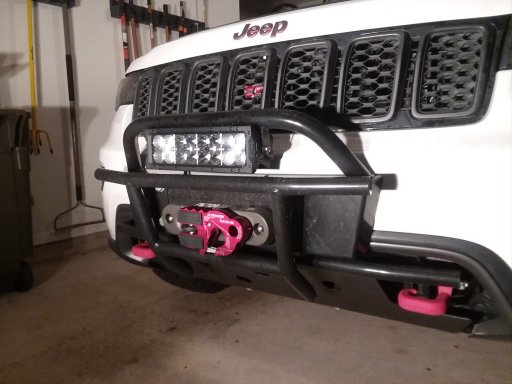

Front Assembly.jpg Contactor Housing Behind Grill.jpg Volvite,
The mounting pattern on the winch base plate for the M8000s and the Zeon Platinum series looks to be similar, but the winches are very different in all other dimensions. I never got an answer from RRO as to which dimension (assuming there was only one) exceeded the space allowances of their hidden winch mount, but when you compare the two winch types side-by-side the Zeons are physically much larger. Regardless, they were adamant that several customers had tried and failed to fit a Zeon (which is sad, because I really wanted to mount a Zeon). You could/should do some research to see if the WK2 hidden winch mount offered by Chief Products allows for the use of a larger winch... I think there is even a build thread somewhere on this site where someone got a Zeon to work with one of their mounts.
To avoid (hopefully) having to access the winch clutch and corded handset plug by digging around behind the grill and fascia, I purchased Warn's Wireless Control System (Warn Part No. - PN 90287) in addition to the basic winch. It plugs into the contactor housing and has so far worked very well. I did not have to purchase a relocation kit since the wires which connect the contactor housing to the winch motor and drum were long enough to work on their own. I only relocated the housing about a foot away and there is between 18 and 24 inches of wire included with the basic winch.
I included two photos - One showing the front assembly with only the fairlead and winch hook showing on top of the RRO's Brush Bar Combo and Bash Plate, and another photo showing the contactor housing behind the front grill.
Hope this helps,
Vin

View attachment 51141 View attachment 51142 Volvite,
Hope this helps,
Vin
Vin,
Thanks for the response and the pictures. So funny thing is, I installed a RRO hidden winch mount and the Warn M8000 winch on my brothers 2015 WK2. I know I took pictures of the install, but for some reason I can't find them. At that time I didn't own a WK2 yet. His install went smooth we just never figured out the best way to use the clutch. With your wireless adapter, do you just use the motor to de-spool the cable/rope? I think that might be the best option to allow him to button up the grill and not use the clutch lever and just hook up the wireless remote.
I did find on Jeepgarage.org the WK2 with the Warn Zeon Platinum 10-S installed with the Chief hidden winch mount. I have yet to find out what are the differences between the Chief and the RRO winch mounts. I can't imagine it's all that different as there's not much room behind the grill to do a lot of different options. I had already purchased the RRO hidden winch mount since I had installed it for my brothers jeep. Just hadn't installed it since I didn't have my winch yet.
