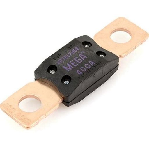

I have 2 batteries in my Willys. I have a Cole Hersee battery master switch, and between that and my winch I have a 400 amp Mega fuse. When I use my winch if I can I keep the engine running at 1300-1500 RPM (I've got a hand throttle) and I switch to the battery 2 position and winch away. I like using only one of my batteries with the winch because if I drain it I still have a fully charged battery to go to for starting, using lights, winching, etc.
(Edit) I used 2/0 welding cable for all my battery ground, engine ground and main power cables. I have 1/0 welding cable for my winch and winch ground, I don't have much if any voltage loss with these cables.

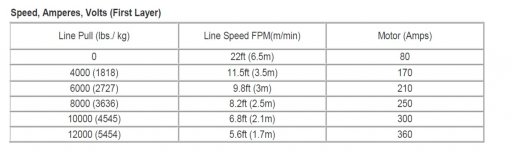

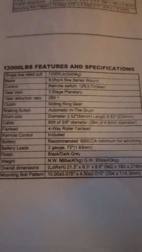

What winch are you running that only draws 170amp? My 13k winch requires 650amp to run at full load. Even my smallest winch 8k uses 400amp to run full load.
This is the specs for my 12k winch....
I think your numbers are a bit off....

Im not sure how you are running a battery with same amp hour as my lawn mower yet running a larger winch than me i run a 13k and my battery is 1000cca. You must have some crazy huge alternator. If its working for you good but i dont see how thats gonna last if you really use the winch.
