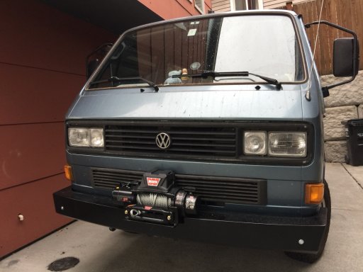

I’m installing a Warn VR10 and trying to decide whether I should connect it to my auxiliary battery or my starting battery. What is the consensus or what is your opinion?
