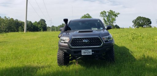

Well I don't drive a jeep but I have a honey badger winch bumper on my taco and am using a 9500 barracad winch with a 16000 lb. 100 ft. Synthetic rope the 2 times I used it

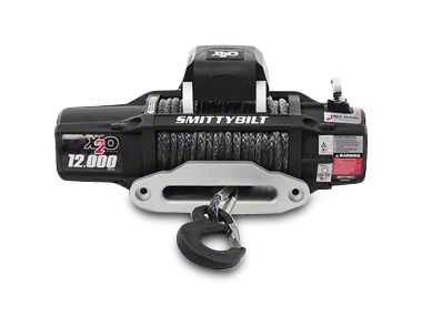

I used my Smitty x2o 10k wireless for the first time yesterday when the inlaws got buried pretty bad in my yard.
I had never wired up my winch but just had the cable rolled up and zip tied behind my bumper, but when their 4 door F250 got a little too far off my driveway in the pouring rain we've been having, they just slid down the hill and went hub deep :( that heavy thing was dead in the water and was no help on its own. So in the pouring rain I pulled into the garage and hooked up the hot cable....would have thought there would have been a Neg cable but theres not....and gave it a quick test before going out and hooking up. I had to tie off my hitch to a large oak because it was trying to pull my 2000 Tundra off the hill with it. It was about a 70' pull up hill with a ton of deep suction mud on their tires, but I was pretty happy with how the winch worked. Their truck was probably 3k lbs heavier than my truck once you factor in their loooong wheel base and camper top full of christmas presents lol. I had my truck running the whole time and it would dim the headlights when I started pulling. I eventually want to get a stronger battery and probably do a dual battery setup plus a bigger atlernator.
I run 2 900 cranking amp deep cycle truck/marine batteries one for accessory one for winch and motor
