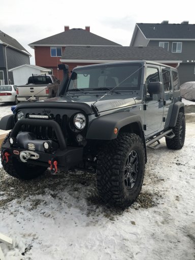

Started out with a 1.5" Teraflex levelling kit and put an ARB stubby bumper with a Superwinch 9500 Tigershark SR winch.
This last winter I swapped out the factory tires for 35" Duratrac tires, added limb risers, AEV snorkel.
Did try the N-Fab side steps but they ended up being changed out.
Installed Bushwacker flat fenders...

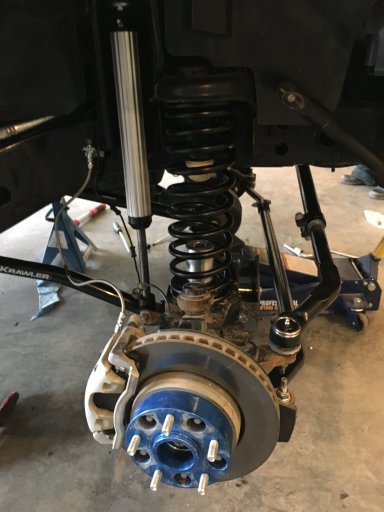

Ordered up a pile of parts including new lift....
New LOD shorty bumper installed, 3 gallon Rotopax cans mounted along with Hi Lift jack on bumper. Lights are still sitting in my shed waiting to be installed...
Now it was time for the lift install...3.5" Rock Krawler X Factor lift with Prodigy shocks. Also installed Yeti flip drag link and HD tie rod. While doing we also put in Synergy track bar brackets and sector shaft brace. Also an Adams front drive shaft.
After the lift...
