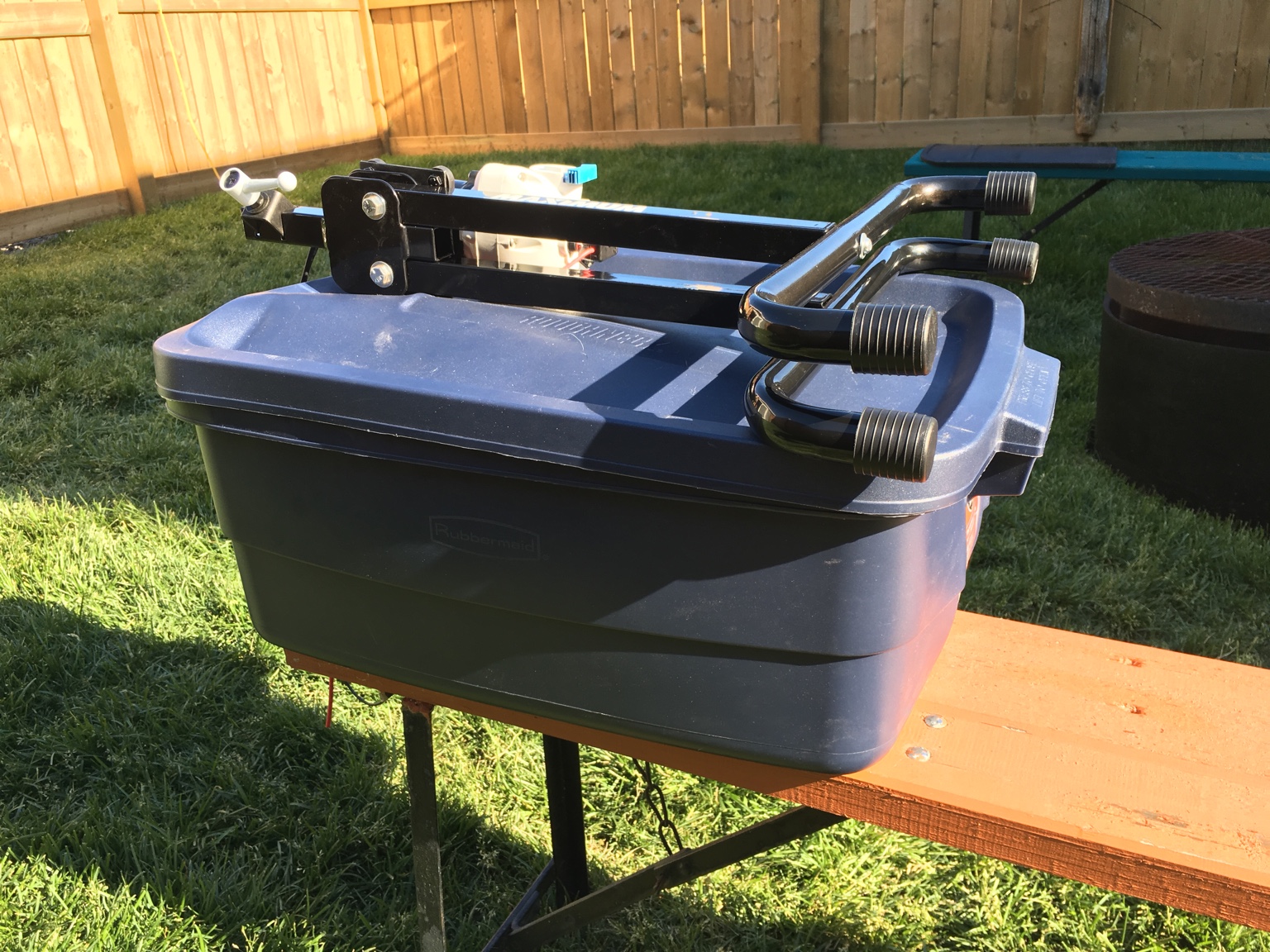

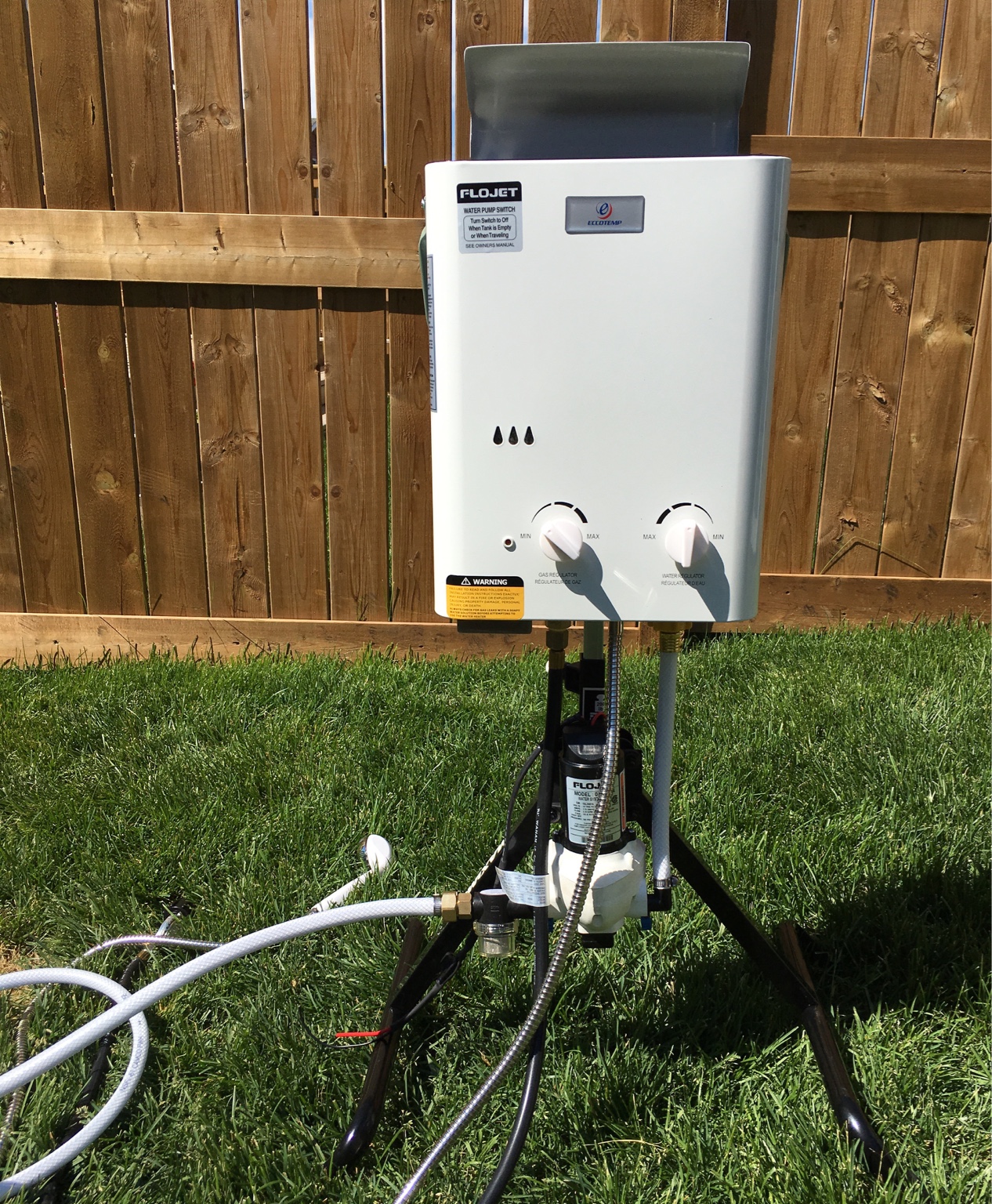

Portable hot shower unit all built for the up coming camping trip to Haida Gwaii. Nothing better than a hot shower I think...

Interesting...
Does it run on AC or DC power? Do you put a pump into a nearby water source?
We typically camp near a lake to wash up but in the spring and fall it's VERY cold (frightened turtle kind of cold).... Lol.
harv3589
1,736
Alberta, Canada
4408
Runs off of my jeep battery....just clip th connections onto the battery and good to go. The hose goes into ur water supply and I mounted the pump on the stand under the shower. I also have a filter just on the in,et side of pump to get ride of the crap in the water.
