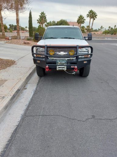

I'm a D'max owner and big fan of them, but I just highly, highly, HIGHLY doubt this. First, are you sure your wheels are 34.1", or are your tires around that size? Second, have you hand-calc'ed the mileage? When I deleted my '11 and still had a 34" A/T tire I could get 21-22 MPG on pure freeway trips. Nobody has ever gotten 24mpg doing anything in a D'max, let 'lone daily driving.
-TJ
My long story short,..........I had a 2001 2500HD with the 6.0 engine. I never got anything over 11.5 Hwy with up sized 285x75x16 tires, over the 245x75x16 OEM's. That was basically running empty. When I traded it in for my 2003 HD Duramax 2500, I saw 14.3 city. After break in, combined city/ Hwy was 15.2......this is uncorrected for a 2x tire size upgrade. The same 285x75x16 tires, as the 2001HD. This is by the dash, not hand calculated. Putting on the ARB bumper and 17.5K winch has not affected the MPG.
From looking at conversion charts, I probably ame getting closer to 17.0 city. This last Sunday I went trail driving.. Filled up at a local station, and did the hand calculation road trip. City, short hwy, and off road 4H and 4L, for a total 39 miles, I got 12.7. This included idling time when I was doing trail cleanup. I can not complain. My buddy was insisting that I would get something like 7.0 combined, and I was hoping for 12, but expecting around 10 mpg. He was pretty quiet after that, as his Nissan 6 cyl only managed 17.9 Hwy unloaded.
I plan on a hwy trip, where I can do the hand calculation method, as I think 20 MPG might be possible. No DEF, no ERG (non CA model), Even with this spike in fuel costs, the torque and MPG allows me to be satisfied with this HD, as gassers are not achieving to much of a advantage to make me look at another vehicle, with reduced capacity. It is not a rock crawler, so it checks the boxes I need.
PS..............That little trip was with MT"s on the truck!
