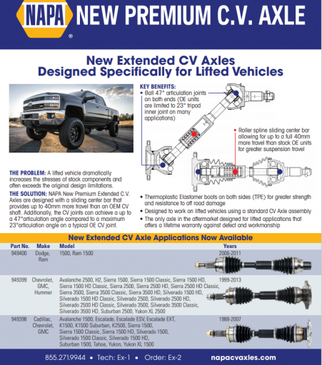

Passing this along. One of several reasons there are so few of these IFS overland rigs is the front CVs are a weak link. Below is a cut sheet from NAPA, which now carries the CV shafts Trakmotive used to offer (briefly). I'm running a pair now in my 2001 Tahoe, and have one less thing to worry about.
Other weak links have also been addressed, such as ditching the front torsion bars for Atomic Fabrication coil overs, replacing the front plastic brush guard with a thick diamond plate skid (fabricated), moog heavy duty rear springs and full auto ride delete, and so on.
Still to address- serpentine does not like water of any kind, or the belt squeal from the water pump immediately starts, the horns need to be relocated as water takes them out as well, and dust constantly clogs the air injection system inlet and evap purge valve.
My opinion is GM is catering to the money, which is high optioned driveway queen 4x4s. To make these rigs work day after day in harsh environments it takes work....
Excellent post,........I bookmarked it. Good info to have, past a specialty aftermarket part that might be difficult to get. NAPA stores are everywhere and their warehouse should be able to get them quick.:grin:
Not wide distribution yet, the transition from Trakmotive to NAPA is not fully up to speed. Bought first one at Rock Auto months ago, last one in stock, then the listing disappeared. Found the second out of NAPA warehouse in LA and had it shipped. Bring cut sheet to store and make them dig.

I dont what CV's to get for the front so i carry a OEM replacement for now, in a few yrs I hope to switch to a solid front axle

I'm building a 1998 Z71 extended cab... I planned on ordering the CV's noted above in the next month or so and want to experiment with relocating the control arm droop bump stops to provide more articulation. I just ordered larger wheels and tires (305/70/16's) to help with ground clearance. I really dont want to add a lift kit as I hate the torsion bar suspension relocation thing. I want to keep my IFS but and am actively researching coil over options but have not really found any information on coil over conversions. I would guess the 99-06 stuff may work with a little work but I would need to see the parts side by side to better evaluate. My truck has the Heavy Half ton 14 bolt rear and heavy rear springs.... it's towing beast. I just wish the rear suspension would articulate better. I installed plus 3 inch shocks front and rear, now I need to get the suspension to utilize them....
Doing a atomic fab coilover swap and a 9.25 front diff swap soon and these axles are great news !!!!
Gotta love how the picture is of a '14 -18 K2 model, while the applications listed end at the 13 GMT900.
Bummer. Anyone know if the 13's fit the '14's?
