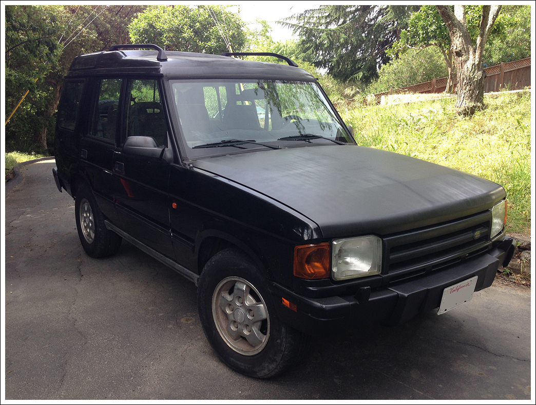

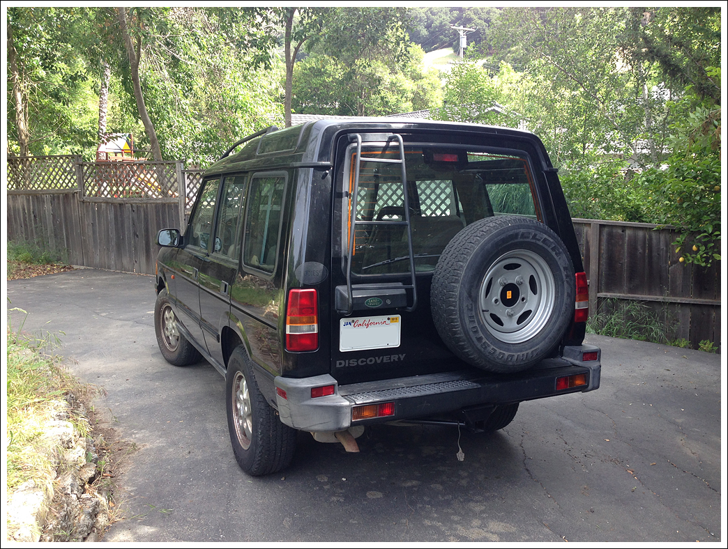

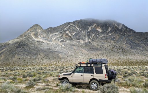

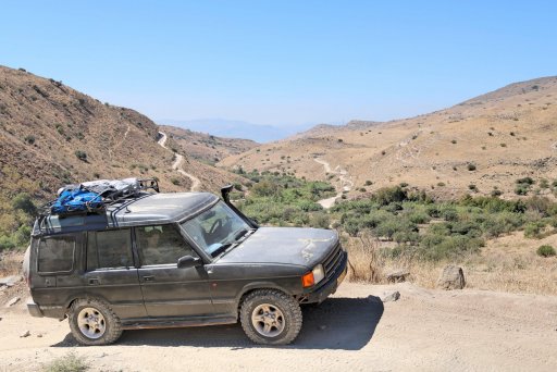

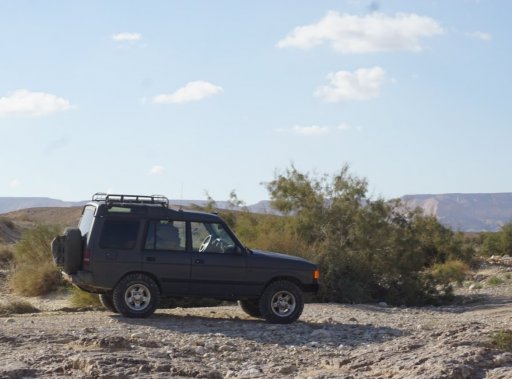

The CA diesel title was the primary reason I purchased it in the first place. But, the truck had a lot of other issues that needed work:
- Major steering fluid leak (fixed this)
- Failed clutch slave cylinder (fixed this)
- Major paint fade on roof and hood (not a big deal)
- Clutch fork punched through on the pivot, and wouldn't fully disengage (big deal)
- Salvage title, supposedly because it had been stolen.
- Interior was falling apart and missing a ton of fasteners. I don't know if this was related to the salvage title, but *everything* needed work. Front seats were collapsing. Radio didn't work. Power locks didn't work. Center console falling off. Headliner falling. I took out all the carpets and pressure washed them, a ton of dirt came out.
All of the above is fixable of course, and given that you can buy a spare D1 for cheap getting a replacement interior isn't expensive. The clutch fork was a hassle since I'd have to drop the transmission to fix it.
The problem was that around the time when I bought this truck my wife (girlfriend at the time) and I were temporarily living in an apartment (no garage) while we planned our wedding and bought a house. This meant the D1 lived in a friend's side yard for 6 months. After the wedding we started renovating the house, which took a lot of time and effort, and I had no time to work on the Disco. It just sat in our yard, and I was getting stressed knowing how much work it required and how little time I had. With the clutch issue and interior falling apart it wasn't much fun to drive.
Ultimately I sold it to someone who knew how rare it was and who was very excited to own a D1 with a 300tdi. If the timing had been different I'd probably still own the truck.
Lanlubber, the pictures are after I spent a ton of time cleaning up the truck and fixing some of the issues. My plans were to put a 2" lift on it and run 235s, but unfortunately I never had time to get it there.
- Matt

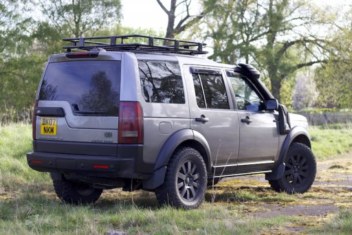

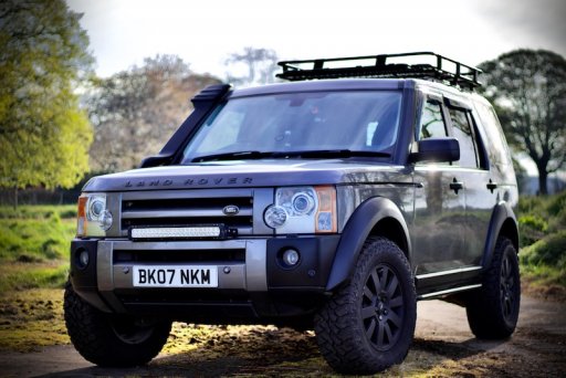

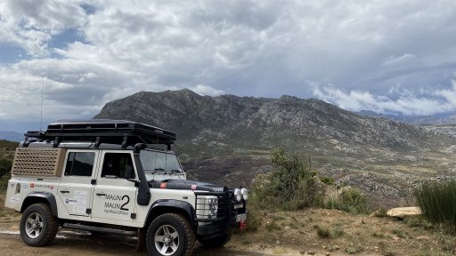

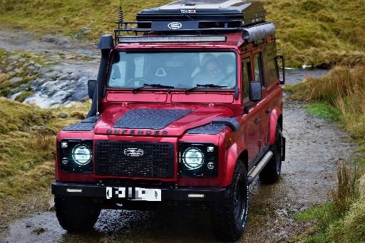

Anyway having just got mine to the point I had imagined in my head when I started building it out and like a proud dad would love to share pictures!

Hey nice Disco, I'm a Defender owner myself. where in blighty are you? I'm way down in sunny plymouth. welcome to OB
