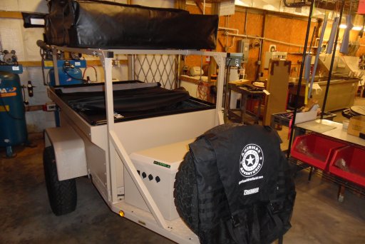

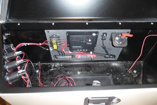

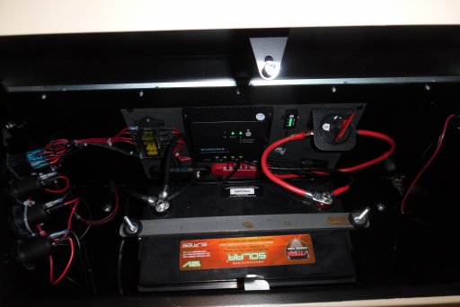

Renogy Wanderer 30amp Charge Controller with battery temperature sensor. Battery is VMax Tank 125amp hour . This battery has a 10 to 12 year life span.

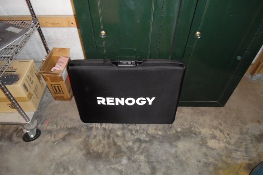

I'm running 2 100 watt Renogy Portable Suit Case Panels (one 100watt shown) were I can run them together or just use one 100 watt panel. I have 20ft of 10 awg cable to move the panels or panel were ever need to.
