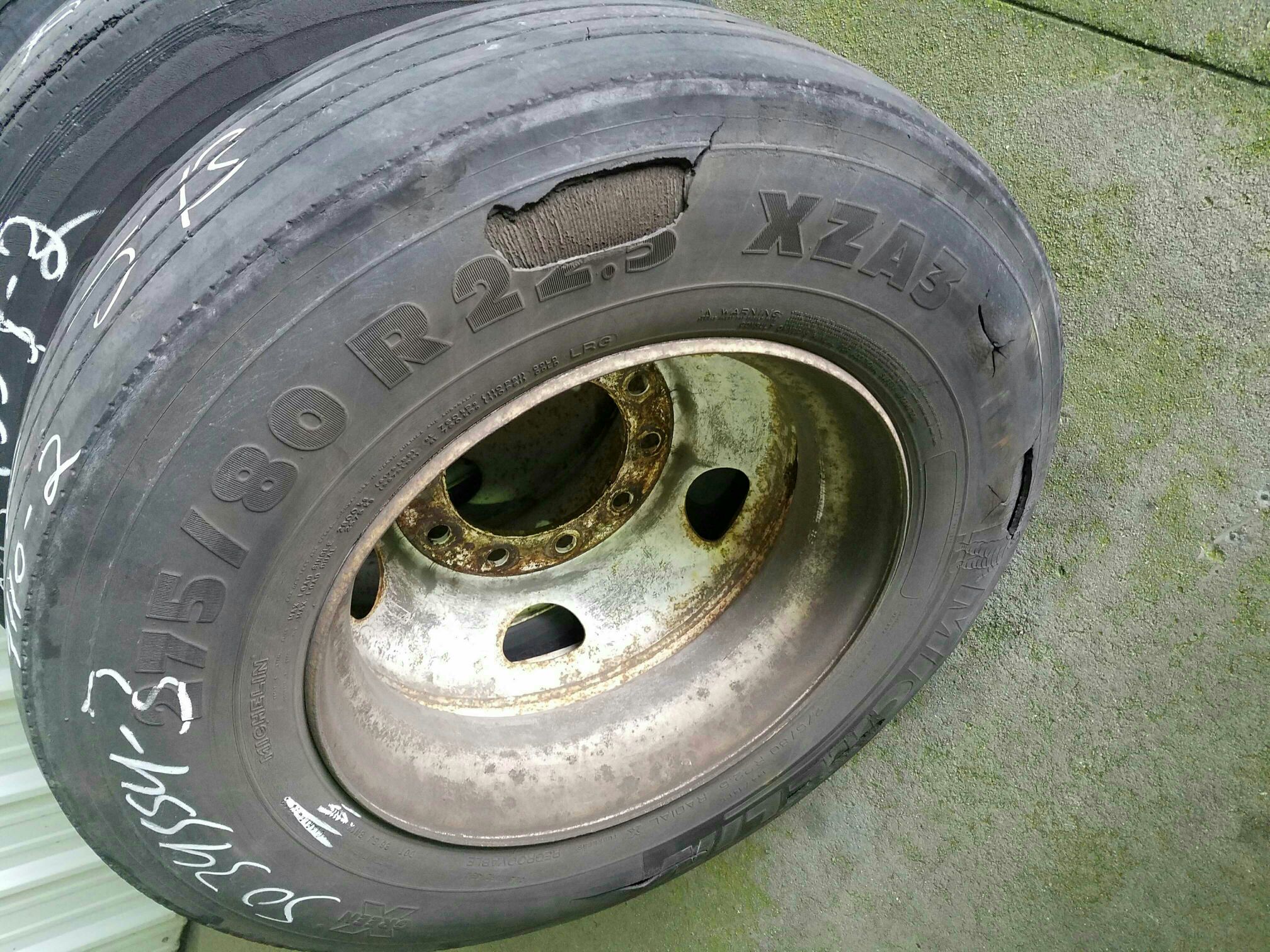

Here is a tire I just removed from service.
It's a semi trailer tire and still holding 105psi. Came in on a loaded trailer.
