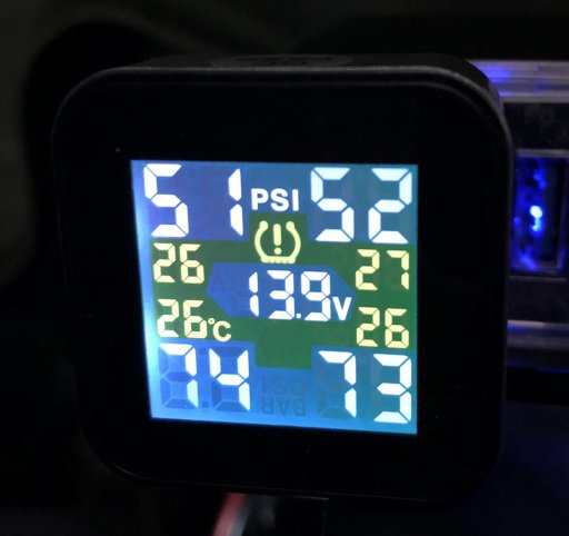

Going to give this a try. I have factory tire pressure sensors on my new cars. My 02 truck, not so much. This got good reviews on Amazon. I normally don't buy anything with less than a 70% good rating. I know, I have low standards lol.
Just installed it. Pretty cool. IMG_3049.JPGHas PSI, temp, and battery voltage. Also has USB port on the side and display is reversible.
