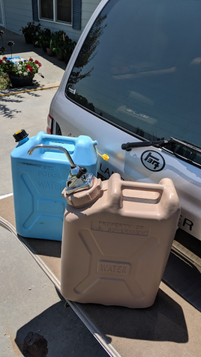

My go-to is the LCI water can with an RV sink pump built into the cap. For longer trips I also fill the blue Scepter can and/or an additional LCI can with normal cap.

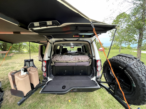

Bjoem, I'd like to see your water mounting set up, have any pictures? I am trying to figure out how to lash everything down and still keep the Rovers utility.
Hi,
Yes, of course. Take a look here.
The freshwater cans live in a box easily accessible through the doors of the 2nd row. At that point I have built the interior exactly for that purpose.
An additonal 20L can is properly fitted in a jerry can holder outside of the rig. Easily accessible.
The 20L solar shower lives on the hood, strapped down to airline rails.
Inside I have installed a few tension belts, where I can lash an additional canister or water containers from the supermarket if necessary.

I used to use the front runner can with the brass tap and it works fine, but recently I have just been using a couple scepters with the submersible pump and faucet that Michael did in a video awhile back. He has since abandoned that because he got a fancy lifesaver filter can thing. (i still need a water filter setup).

For camping using the '97 4Runner (a smallish vehicle) the Scepter 10L MWCs are my preference. I like their size and weight when filled. Also, if the vehicle crashes into a ditch or rolls over in a remote, waterless area, the Scepters will likely survive. The thin-walled consumer cans seem more fragile.
