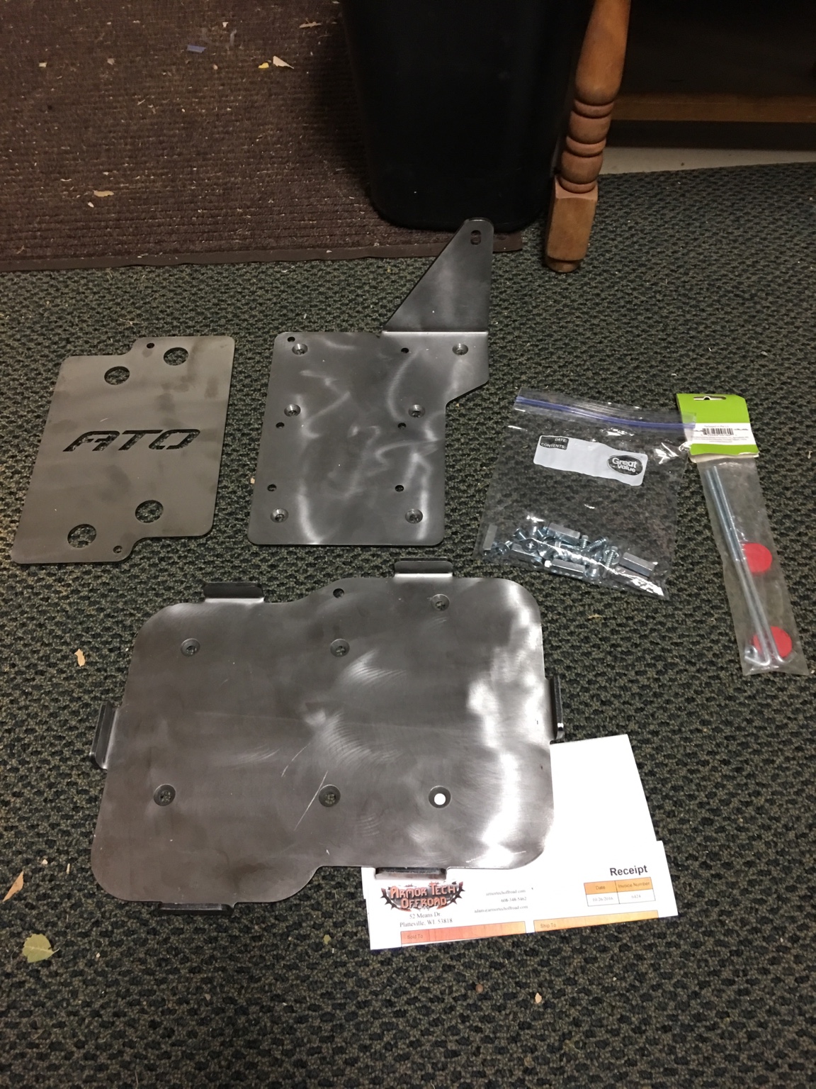

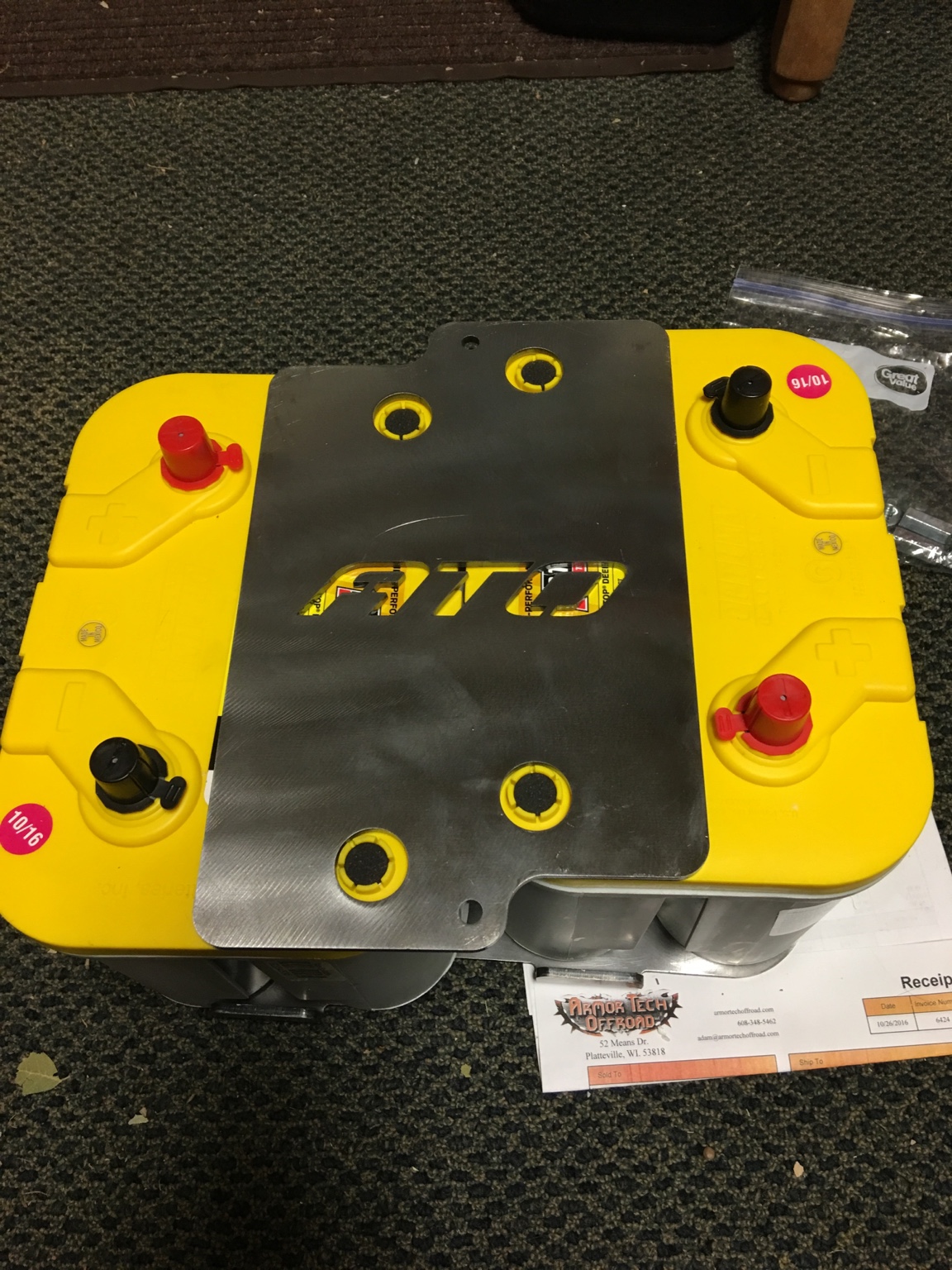

What battery system do you go with.
I have a dual battery bracket/hold down from Armor Tech Offroad and two Optima Yellow Top group 34 batteries waiting for installation in a few weeks.
I am going to be using the IBS battery system to control the charging.
I am mounting a Blue Sea 12 circuit fuse block under the hood, behind the OEM fuse box. It will be mounted on a plate made by Pelfrybuilt.
Cheers
-- Bennett
