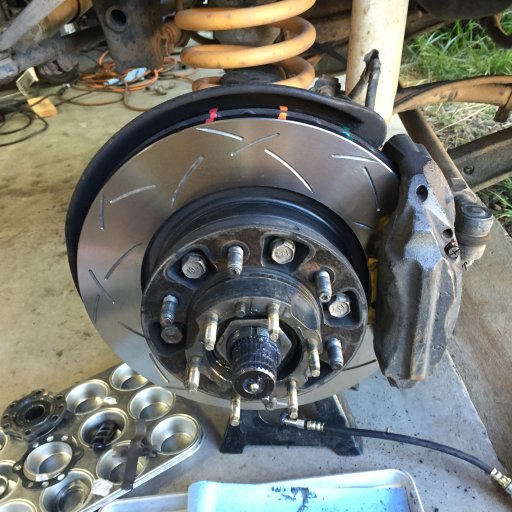

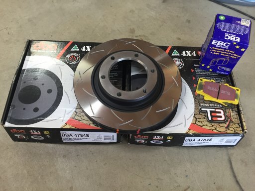

Front Brake Job.
Not real exciting but I'd figure I'd share. They were not due for replacement but one of my rotors got warped last month when a wheel bearing became loose while dropping into Silverton CO on the HWY. The star washer that locks the two bearing preload nuts in place failed. The key inside the washer sheared off allowing both nuts to turn as one. Anyway heavy braking turned to death wobble as a result. And the drivers rotor warped in the process.
So on to some pictures.
If your familiar with Toyota solid axles then you know the whole hub has to be removed to replace the brake rotor as it bolts up the the rear of the hub.
New and old. Both DBA's but the new ones are no longer directional.
Reassembled, well almost. I prefer to set up the preload with the wheel/tire bolted up.
What was really impressive was the condition of my old DBA rotors. The spec for a FZJ80 front rotor is 32-30mm. (Thickness) My old ones measured 30.85mm and 30.90mm. Which is pretty impressive for rotors with 90,000 miles on them. Under a heavy truck, that tows often, and I live in the mountains. It goes to show that premium parts are worth the money. Most people think the 80 series eats brake compnents. Personally I've not had that issue. Maybe they use cheap parts?

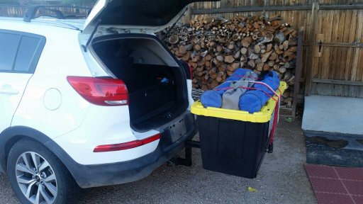

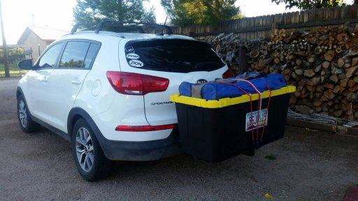

Needed some extra storage, so we fabricated this hitch mounted case this week. We put it on a slide so I can open the hatch, yet slide it close to the truck while traveling. Large enough for the bulky 18x20 tent, 6 gallons of water, cooking gear, and some other odds and ends. Should be able to get a few more mpg than with the roof cage, that I used earlier in the year.

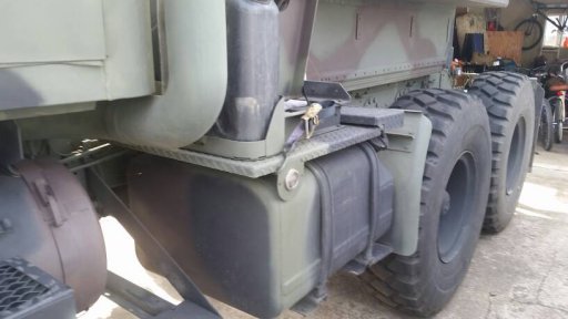

I found a great spot for my member emblem on my 6×6 "Motorhome"
Nice!!!!! That's a beast of a motorhome. Can't Waite to get my emblems either, ones going on my Jeep and the other will be for my OffRoad trailer when it's complete.

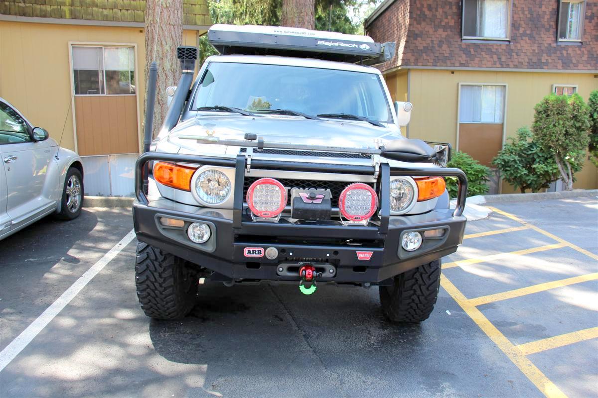

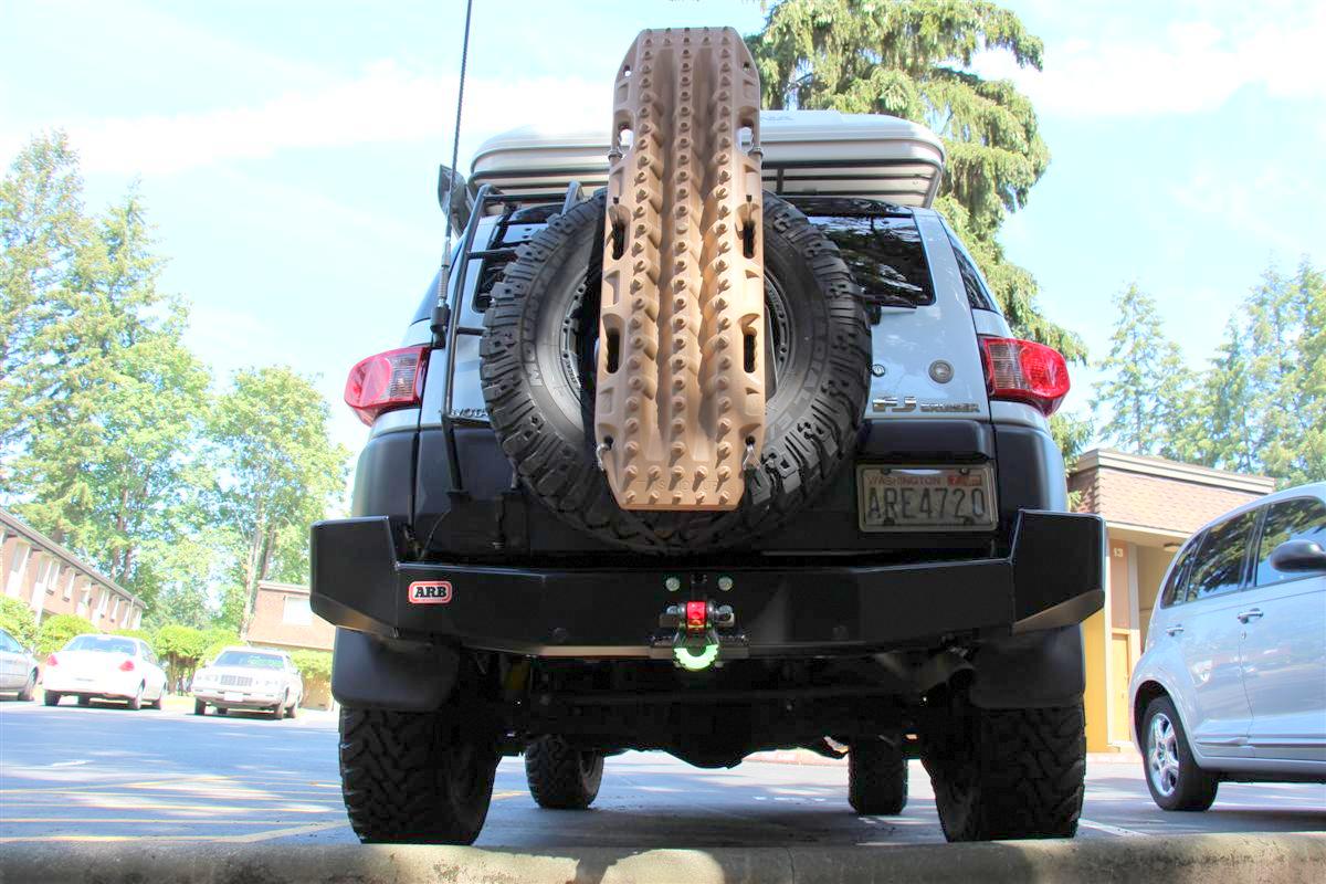

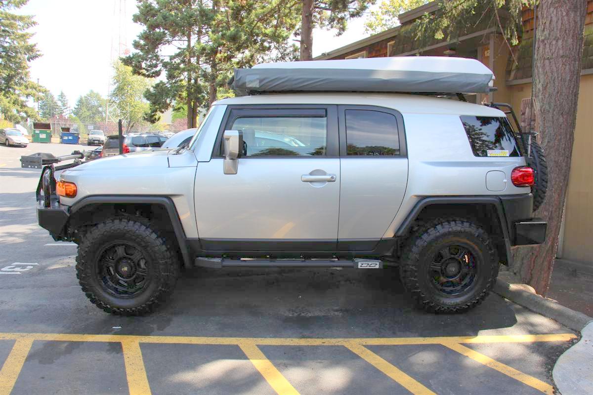

I added 10 horsepower today.
Everyone knows stickers add a few extra horsepower, but did you know Daystar D-Ring/Shackle Isolators add 5 horsepower each?
I got a red set and a fluorescent green set delivered today from Amazon.
Trying out the fluorescent green ones now front and rear.
Also got up early and was out washing the rig before the sun came up.

How does your maxtrax stay on your tire?
