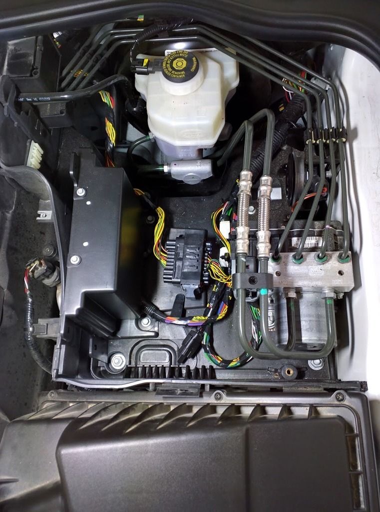

I finally started on my dual battery install on my 2013 LR4. I've had the kit just sitting around for awhile.
It is about 90F and very humid today, so I mostly started on clearing space in the second battery box area for the aux batt. I will run the wire next week when the highs are 72F!
Starts out like this. With the black box on the left being a case for the transfer case module. That can be moved over to the horn bracket under the brake lines with the flex hoses. Have to move the large electrical connector, etc out of the way...
Before you know it, you have room for an aux battery... in this case I am going with an Odyssey 34-PC1500T batt for an aux and a Exide Edge FP-AGML5/49 for a better and slightly larger starter battery.
Plan is to get a fridge freezer for the second row middle (took out the seat) and ill have a hard mounted inverter in the back. The cig outlets all get wired to the aux battery. I might also figure out a solar charge setup in the future which works great with this kit because it supports reverse charging of the starter battery and aux battery at the same time, while still having the starter and aux batt isolators (independent)
