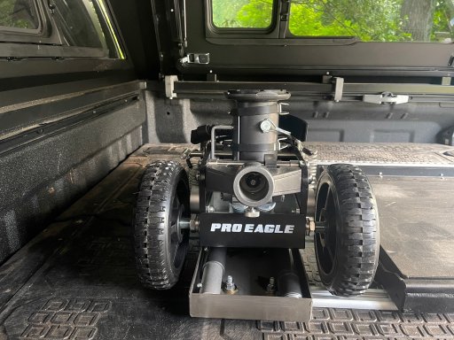

Not exactly today, but this week:

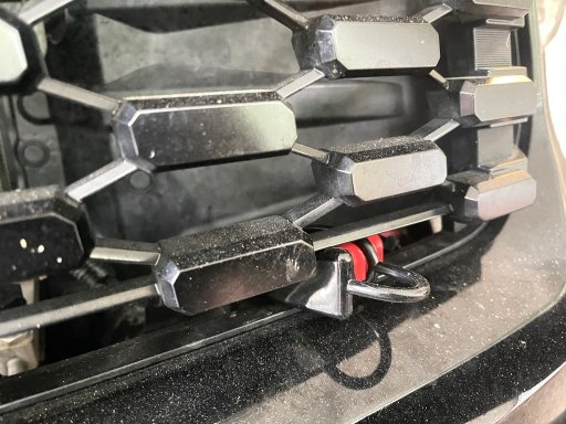

- Cut the battery clamps off of my Viair compressor, installed Anderson plug. Ran wires from the battery in behind the grill with an Anderson plug as well. Basically a QD attachment for my air compressor so I don’t have to fool with popping the hood.
- Installed my ProEagle Jack and cradle onto my Decked drawer system. I use the Decked Yakima/T-slot tracks to mount my fridge slide and the ProEagle cradle. Had a lot machine shop slot out the bolt holes to have some room for adjustment for the cradle.
- Had the same shop slot out the bolt holes for my Alu-Cab tilting fridge slide. The holes were off just enough to cause some binding while trying to use the slide.

That is a GREAT idea w/the Anderson plugs for the Viair.
Thanks for that great idea!
Unfortunately, ProEagle's Largest Capacity Jack - 3-Tons - isnt quite enough for my rig...bummer.

A 3ton Jack is enough for your ram 3500. You’re only lifting a single corner, not the entire truck

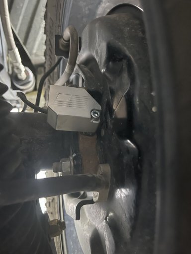

I took a 30 minute job and found out it turned into a 3 hour job of just installing a simple set of ABS guards on my 4runner.
The front was super easy, bolt out, guard on, bing-bang... The rears were a nightmare!!! -- No room to get any sized wrench on it and the da#$)* bolt would not thread properly to save a mule on a train carrying a sack of gold... just annoying.. My left hand looks like I was in a bar fight - knuckle busting... The videos always look so dang easy....
Anywho - got them threaded * I use the word lightly as more in then out... hope I never need to replace those darn abs sensors...

Awesome idea for the air compressor. Might have to borrow that.
