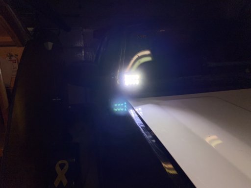

Bought some rock lights to change my reverse bulbs to LED's to make the brighter and lower the voltage. Made a few mods to the bulb housing and got them installed today.

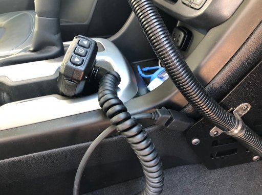

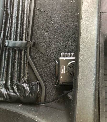

Installed my Midland MXT275 in the truck today. Radio body is under the back seat velcro'd to the carpet.

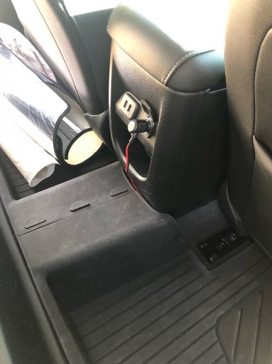

The power leads are not long enough to get to the battery, and I didn't feel like extending them, so I used the rear 12v plug in the console.
Ran a mic extension cable to the passenger side of the console.
Antenna cable goes out the rear vent and into the bed with the antenna on an NMO mount on top of the aluminum camper shell (but I forgot to take pics of the antenna).

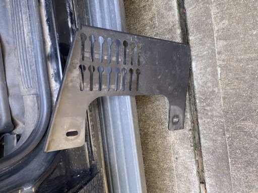

Installed the base left over from the other wonder twin into thecopcar. It’s the floor plate for a laptop desk.
gets it outta the way in the garage, and ultimately gives some mounting options for future upgrades.

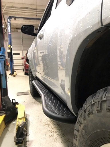

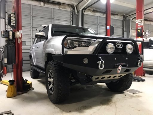

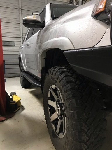

Put sliders on after work today. Budbuilt got them to me nearly a month earlier than they had promised when I ordered them on their Black Friday sale. They fit great!

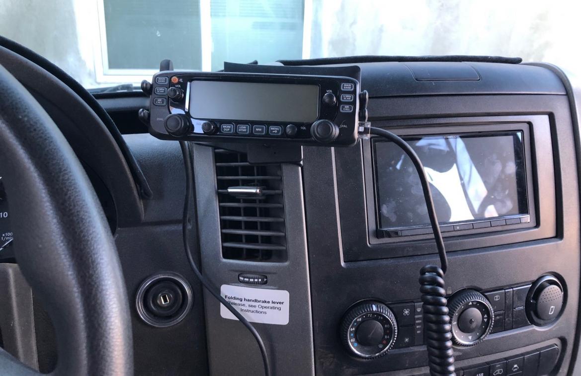

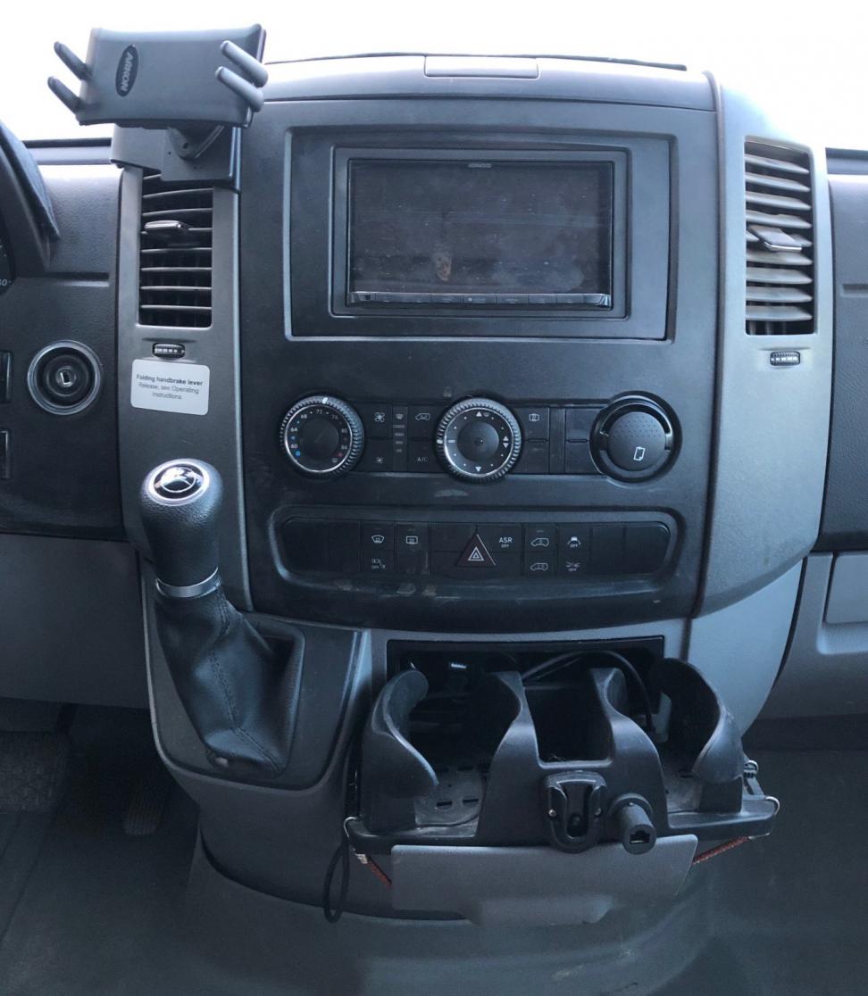

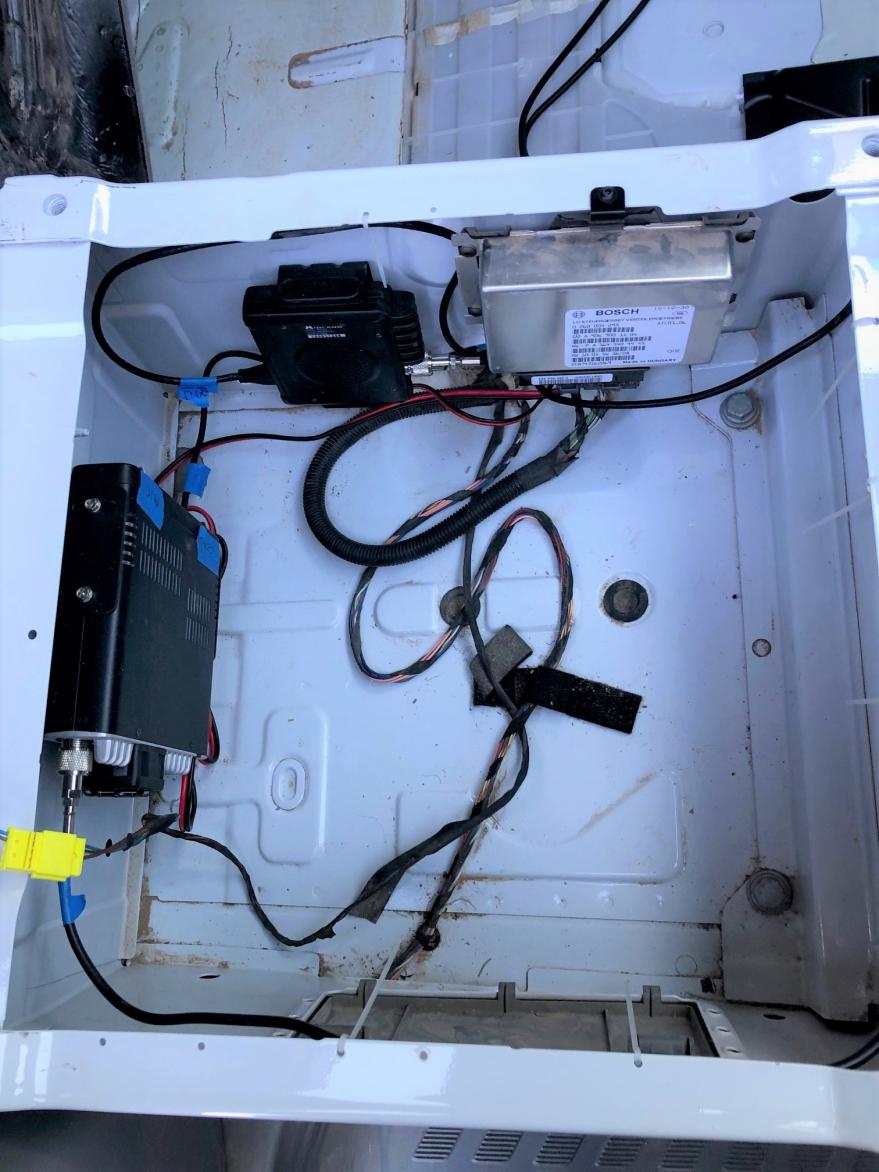

Installed the Icom 2730A HAM radio under the passenger seat in the van and moved the GMRS radio there too. Didn't really like it under the cupholder where I installed it originally.
This image has been resized. Click this bar to view the full image.
I used a Pro Clip mount to hold the head unit for the HAM and ran a mic extension to the cupholder for the GMRS. I haven't installed a mic holder for the HAM yet.
It's pretty incognito when the head unit and the mics are removed.

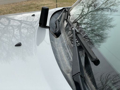

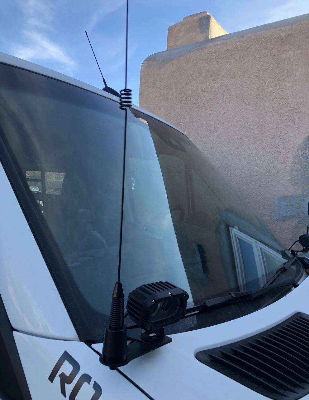

Both antennas are on Rago mounts which attach to the VanCompass ditch light brackets.

That's a nice clean install! Do you get any whine/buzz/interference over the radio when you turn on the lights? (what brand lights?)
