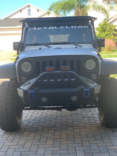

You just cant beat the looks of one of these things (the whole rig) I love the green color. Super nice rig my OB friend !
Is this a swing out kit you added to an aftermarket steel bumper yourself. If so where did you get it.
It is a kit from summit cruisers. Added to the original steel crossmember.

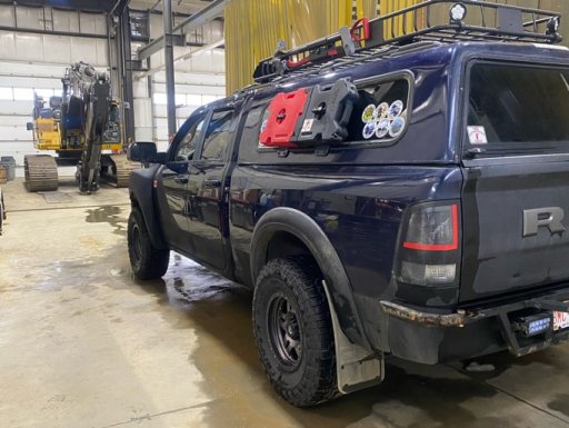

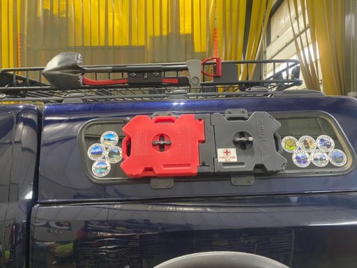

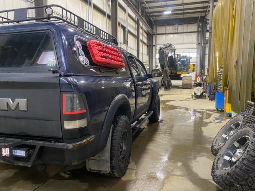

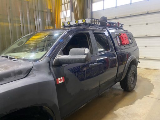

Installed a new fuel injector, 2 new ruthenium hx spark plugs and a new blue streak coil in hole #3, reset all engine values and hope for the best. I’m hoping it’s not the lifters starting to take out the cam shaft, damn hemi problem. Picking up a tuner this afternoon to shut off the mds system too. Figured while it was in the shop might aswell wash her and finally install the axe and shovel holder too.

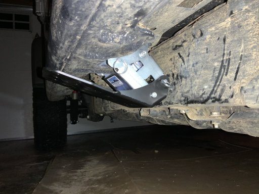

Got two M.O.R.E. Hide-a-steps installed, on front driver and pax sides. First took a couple hours to install, the second 30 minutes... Pull the entire rock rail and support it on jack stands nearly in place to allow the step base to be weaseled in.
What a mess under there!

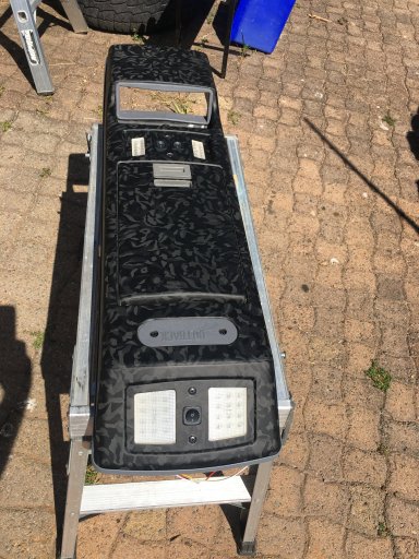

Got the tub the rest of the way painted. It's not the greatest. Its a "100 foot" paint job. I tried my hand at bondo for the first time.....you can tell
Looks better than the red Jeep that rolled off of Black Bear pass recently.

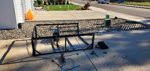

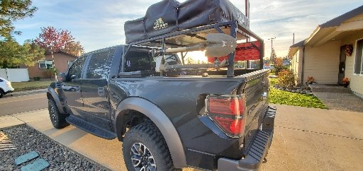

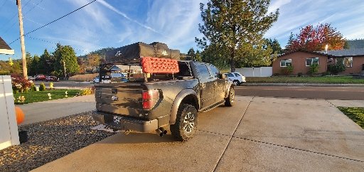

Spent some time tweaking my rack setup today. Every time I set up my tent I have a hard time walking around. Specifically on the traction boards side. Since I had them flush with the bedrails it made it impossible to walk around. So I added some super strut near the top of my rack. I think other than different mounting hardware it will work great. I also had another member come over to help me put it all back on the truck. @Jonathan01 thank you for your help bud!
