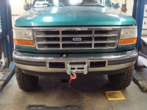

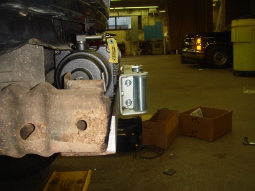

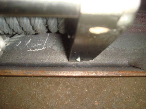

How well does a dodge power steering pump fit on a Ford Bronco ? How will you install the winch on the Bronco with the stock bumper ?
As @TahoePPV said the power steering pump is actually based on a GM pump. However, Ford used the pump on some full size vans in the late 80’s through the 90’s. I had to get a bracket from a 1992 Ford E-250 Van with a 351 Windsor to make the Steering pump swap. I took the Ford Saginaw Pump and put it on the Ram because I highly modified the Ram Pump to work with the winch. All in all because of the winch, it’s a bolt on procedure.
As for the Winch install with factory bumper... A 8” x 1/4” x 38” piece of structural channel Iron, and some 3” angle is all that is needed to make my cradle that ties the front frame rails together. Drill some holes, cut a hole for the fair lead, and bolt it all together. Actually quite simple and looks good too... I didn’t come up with the idea, but it’s a good one.
(Not my pictures)84BD6C18-465F-4671-A50D-5DED82D87FF4.jpegA22FCB16-6C00-4576-9E2B-292EDACDD118.jpeg4456AE9D-C1F9-4FCB-ACAD-5EF72E6C7B9C.jpeg

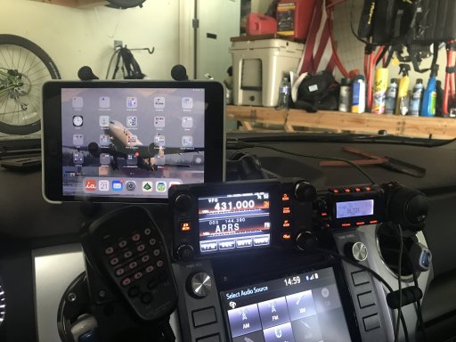

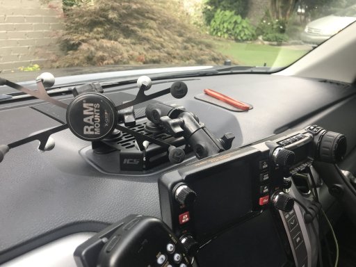

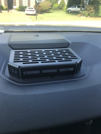

Finally got around to install the ICS Fab Dash Mount

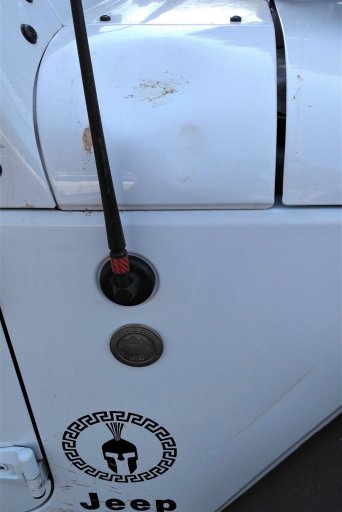

Did some off roading and on a steep rocky hill climb, I flipped a log up into the cowl. Fresh war wound #^@%!

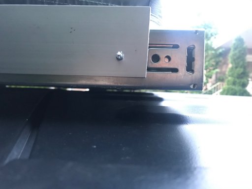

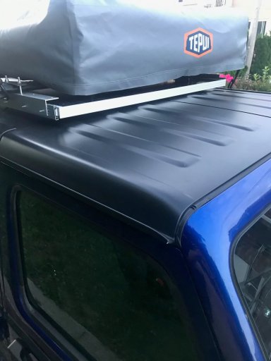

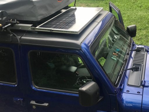

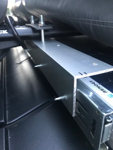

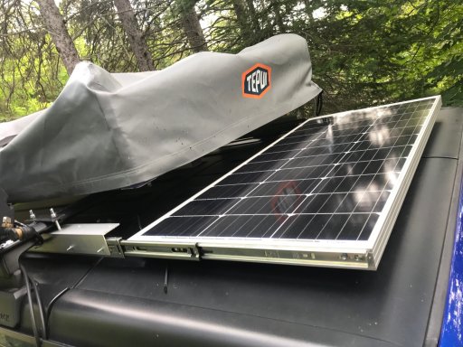

today/yesterday I installed my 100watt renogy solar panel, the freedom pannels have just enough room to still come off
I like that I can leave it in place and just slide it out when I need it, less chance of it getting damaged and my only draw on the deep cycle battery it charges is the fridge when we will be stationary for 3-4 days at a time. I will have to park with the front of the car south from now on to get the juice but the panel has done ok so far. she charges she charges,
Yes those be some pointy selftap screws coming out i have to cover them with some rubber knobs, I contemplated about cutting off the ends but im afraid that my aluminium bracket is too thin and they will fall off with vibrations
cost of panel 136
controller was 35
deep cycle agm battery plus box with the 12 volt socket and v meter 420
extra wires with mc4 already terminated was 26
slides, bolts and misc was bumed off relatives lol
so it cost about 600 CND dollars for a 105 amp/h system with solar to keep it charged, less than half price what it would have cost me to buy a jackery 1000. (1300$ plus solar panel 1450ish$ in canada) sweet baby jesus....

That’s very slick!
