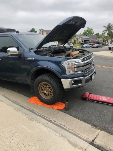

Today was tranny filters and fluid day in the 2500hd. You know they make two filter sizes for the pan filter? A deep pan and a shallow. You would think a truck that can pull 14.5k lbs would have a deep pan. that would be a nope..... Just like a house project, at least two runs to the store. Done! Smooth shifting again.
