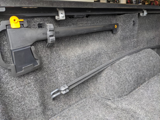

Mounted Fiskars 28" Axe in bed of Silverado using quickfist mounted with the factory bed tie down mount. Removed tie down bolt and replaced w/ hex bolt. Mounts flush to pocket in bed of the truck, very low profile, very stable, mounted just inside on driver-side. Handle weighs nothing so currently unsupported. I will likely grab a small loop of velcro to hold/attach the end of the handle to BedRug. Got the idea from SilveradoSierra.com forums.

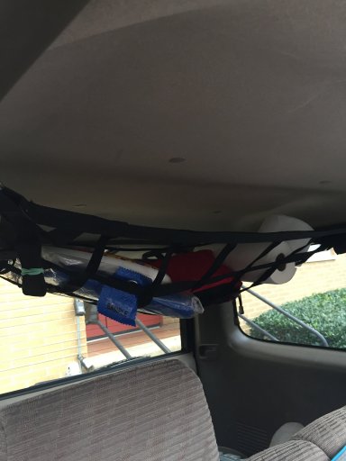

Rachel and I installed a Raingler “gear hammock“ to help organize some of our kit. We’re not sure what we’ll end up keeping up there... but for now I tossed our first aid kit and some paper products in the hammock to see how it works. I rubber banded the excess strap for now, maybe we’ll trim it or Velcro it later.

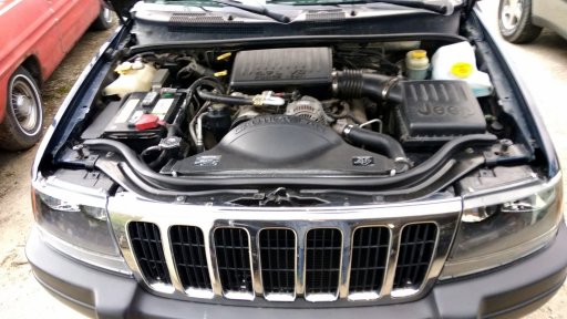

Completed WJ project today. Convert from the '03 hydraulic fan to '99 Electric/Mechanical fan combo + ZJ windshield washer fluid bottle mod + convert hydraulic cooler to transmission cooler. The plan was to use as many stock parts as possible and perform the mod such that it looks factory. "While I was there" scope creep had me go from timing chain tensioners outward. It has been a long 3-4 month planning and buying parts and a 3 long weekend wrenchfest. Defective or wrong out of the box new parts has plagued this project, but I overcame. A 25 mile test drive today showed a few annoyances to deal with (2 defective parts issues and electric fan controller logic to sort out), but the mod has met my goals.
Edit: After the test dive yesterday and running errands today, the main issue found is the new radiator is definitely leaking from the drain valve, and possible leaking from a plastic seam on the underside of the cap neck. I'll keep an eye on the seam, if leaking is confirmed then I will need to replace the brand new radiator. If it is only leaking from the drain valve, I'll just epoxy that sucker and call it good. A radiator job on a WJ is not a fun thing to do. Another little fix I need to do is clear a low washer fluid alarm. Evidentially I did not guess the sensor logic correctly. But that is an easy one and a quick fix when it stops raining out. The other suspect part is the new AC condenser. One connection port was pretty scraped up right about where the O ring will land. I'll see if it will seal when I have the AC recharged. Worse case, I will need to replace it with another new one. Lastly, once the AC is charged, I will be able to check to see if I pulled off the right AC signal to trigger the electric fan when the AC button is pressed. But the good news, it's running great at a steady 195 degrees (then again it was 59 degrees out today...)

Completed WJ project today. Convert from the '03 hydraulic fan to '99 Electric/Mechanical fan combo + ZJ windshield washer fluid bottle mod + convert hydraulic cooler to transmission cooler. The plan was to use as many stock parts as possible and perform the mod such that it looks factory. "While I was there" scope creep had me go from timing chain tensioners outward. It has been a long 3-4 month planning and buying parts and a 3 long weekend wrenchfest. Defective out of the box new parts has plagued this project, but I overcame. A 25 mile test drive today showed just some annoyances to deal with (2 correct defective parts issues and some fan controller logic to sort out), but the mod has met my goals.

Oh how good it must feel to get that job over with and get back on the road again. It looks very nice and very professional.
You are to be commended.

The whole "defective or wrong out of the box" thing just freakin' KILLS me!! We get that at work constantly. There is no pride in providing quality anymore. It's only about taking your money. Grrrrrrr.....
Way to overcome!!
