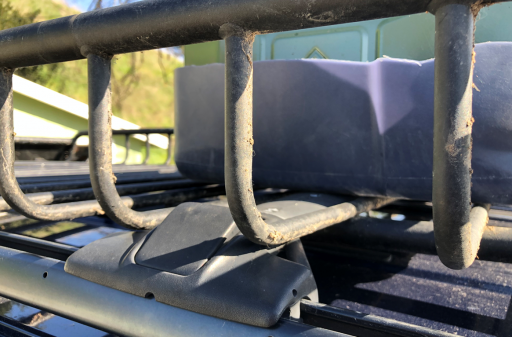

Sunday played with a roof rack mount idea. I'm not a fan of roof racks on daily drivers (gas mileage waste), nor do I care for much on the roof on the trail (higher center of gravity). But when you need one you need one and they have a place. The upcoming trip this spring dictates pulling a trailer, roof rack, or overstuffing the WJ. I voted roof rack as my first option if I can make it work. The standard mounting has the rack sitting way too high for my tastes so it has been unused for the last 2 years. After recently seeing a Toyota with flipped mounts I thought hanging the basket from the cross bars might be the solution (there is no room to do the Toyota mount flip). The mock up worked well, with the rack sitting nice and low with about an inch and a half clearance from the roof. Looks like a winner, and with attention to crossbar placement the rack is reasonably level despite the descending roofline. Next weekend I'll figure out the crossbar to rack and cross bar clamp to rail mounting.
Edit 2/16/20
Worked out the final mounting. Holes deburred, all fresh exposed metal painted, locktite on the nuts... if was a nice day to work outside. Happy with results, it's tucked tight and low. But like any install using factory cross bars, strength is all in how the factory plastic ends hold up. Will be testing it on a 10 day Utah trip in a few months. I have plan B already figured if they show failure.

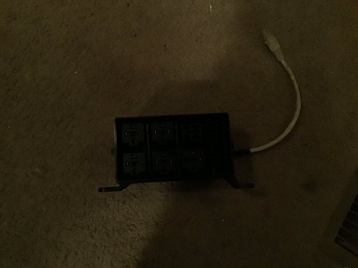

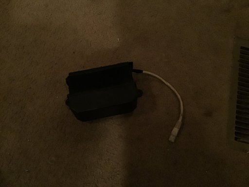

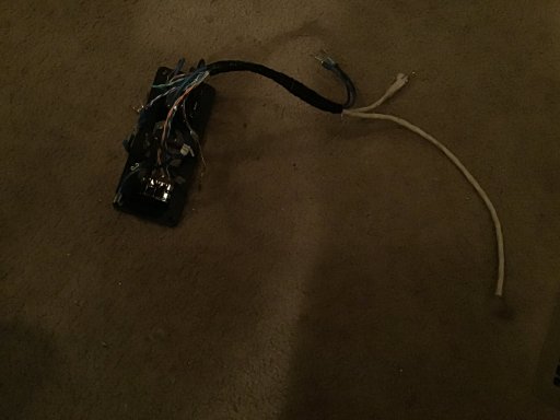

Almost finished with my auxiliary circuit box/switch panel... panel Is wired, just need 3 more switches. The circuit box still needs multi colored 12 gauge wire, and a couple of connectors, then I can install the system and make my wiring harness to connect the two together. image.jpgimage.jpgimage.jpgimage.jpg
