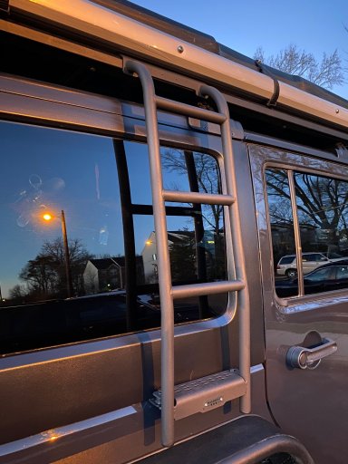

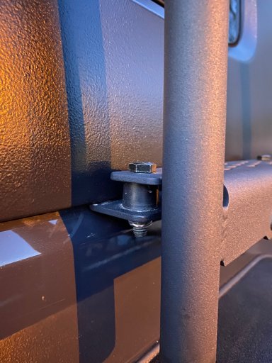

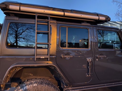

Installed the Maximus 3 side ladder onto my Rhino Rack with Backbone. Technically, it's only designed for the Maximus system, and even though there system uses the Rhino Rack Platform, the Platform sits in a different position height wise, so the ladder isn't sold to work on the Rhino's with Backbone.
Ended up making some small spacers to take up the height difference, and drilled my holes in the tub of the Jeep in a slightly different position to put the ladder closer towards my rear door. My point for running the ladder is so I don't have to carry the telescoping ladder for the RTT any longer. Less stuff inside. I think it turned out pretty well, and it gets the job done!

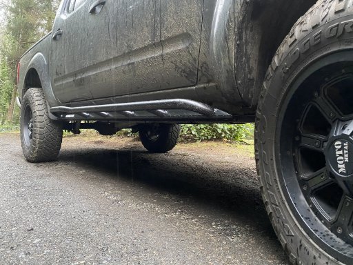

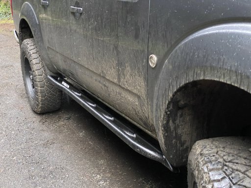

I've had these sliders since October, and that's right about the time the weather turned to rain. I don't have a shop/garage, so I've been waiting to install. Got ahold of a buddy of mine & we slammed 'em on this afternoon.
I love my WKO sliders! They've taken some pretty good hits too! Right now I need to give them a light sanding and hit them with some rustoleum to cover some of the places I've knocked off the powder coat recently. Gotta wash the X first though!

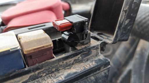

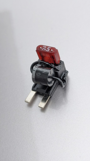

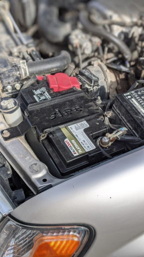

Upgraded my starting battery to a H7 AGM with a group 34 spacer. 850 CCA, 140min RC and 80 AH is a nice jump from the stock 27F. Also installed a hold down that came with a Group 31 tray I've never used. Could have reused the original hold down, but it was corroded.
Increased charging voltage by 0.5 volt to make the AGMS's happy with a diode on the alternator sensing circuit:
Then I spent a lot of time on roads currently set to "Defrost"
