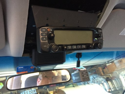

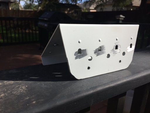

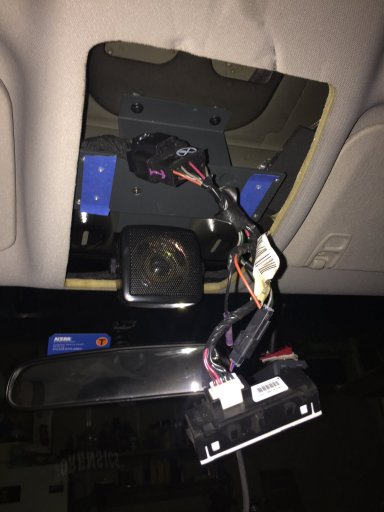

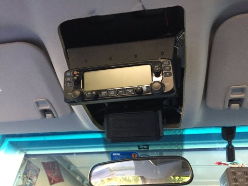

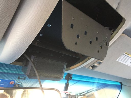

Fabricated and installed a bracket for the head unit on one of my ham radios. The prior owner removed the overhead console to mount the lights and sirens controllers. They did thoughtfully leave the mounting bracket so I had a hard point to rivet to. B1924957-1EDE-4B3A-8AA3-C3721AE748E1.jpeg30C2AB2E-1DE9-4A7C-B9FE-B8716B77DF19.jpeg98C81C95-43C4-41BD-9F98-2DF09EBFEA5A.jpeg83118B50-29E7-43DA-A309-C6DA46B7D710.jpegECD54D34-8B6E-4A7F-8E69-9A26D859D86B.jpeg

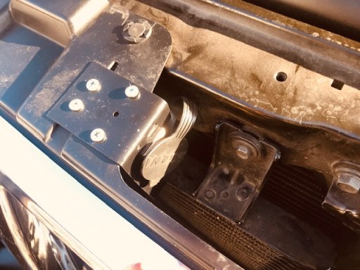

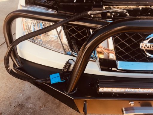

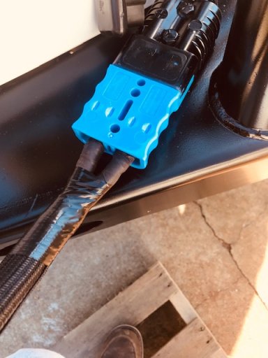

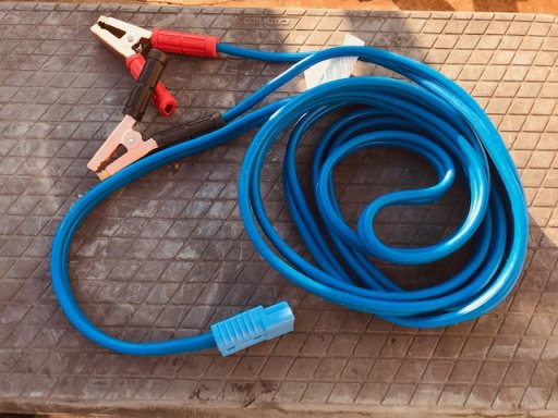

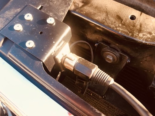

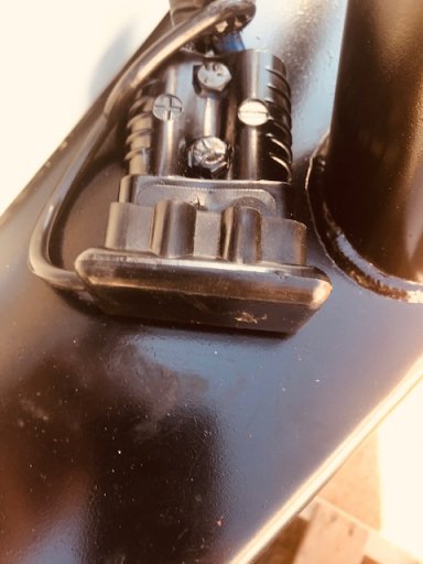

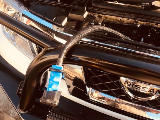

Today, I mounted a Andersen Power Connection to the top of the winch bumper, next to one of the grill-guard up-rights.. The cables from this connector is attached to the battery. It is part of a 20' jumper cable with Andersen quick connections.
The cable(with blue connector) is the power supply to the winch. I don't like to have the winch connected directly to the battery. You never know what can happen.
Yes, I could have installed a master cut-off switch, but I have limited space under the hood. Besides, I already had the quick connect Andersen jumper cables set.
If the winch is ever needed, I'll open the hood and pull the cable out from it's storage location, behind the grill and plug it into the Andersen connector.

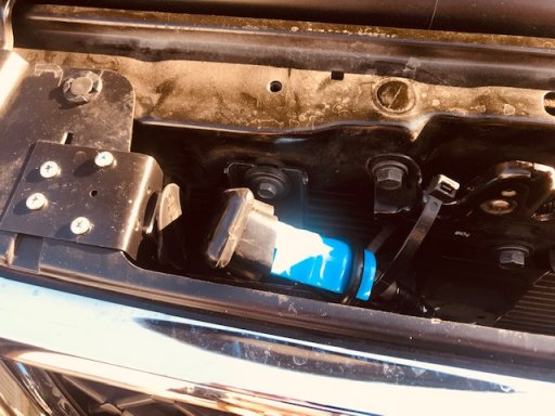

Below is a pic of the winch power supply cable pulled from it storage location.
Winch cable in storage location, next to the hood latch.
Winch operating control cable connector mount behind grill.
Winch operating control cable attached to connector.
Below is the 20' jumper cable set with Andersen quick connector.

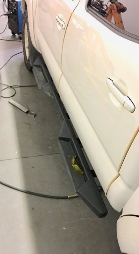

Today the project of converting heavy steel steps to true rock sliders welded to the frame was completed. My truck was not built for rock crawling but there's always the possibility of that "oh crap" moment coming down off a ledge or something. This will definitely save the rocker panels.download_20191122_172647~01.jpgdownload_20191122_172647~01.jpg
Did you buy the jumper cables with ends on them already, or modify a set. I've been meaning to add connections out my grill for jump points just havent taken the time. Looks good, clean install!

Today the project of converting heavy steel steps to true rock sliders welded to the frame was completed. My truck was not built for rock crawling but there's always the possibility of that "oh crap" moment coming down off a ledge or something. This will definitely save the rocker panels.View attachment 128591View attachment 128591
Excellent call. The first thing I installed on my Tacoma was a set of RCI rock sliders in preparation for an upcoming Moab trip (Jeep was down due to shoddy work by a local shop, eventually repaired by myself but not in time for the trip). We didn’t do any red trails but returning on the Colorado River overlook trail in Needles, the right rear tire slipped off a rock and the kick out portion of the slider stopped the side of the truck from slamming into a vertical rock wall. Boom, $$$ spent justified!
You need not make excuses for adding protection to your vehicle. Rocks are not the only way to damage the rockers. I like the insurance myself. Cheaper than a body shop by far.
I used to install these on Service Trucks. I've been having a couple set from before I retired. They were bought from NAPA. They're not cheap. If I were to purchase more, I'd shop Amazon. They sell these in many lengths.
