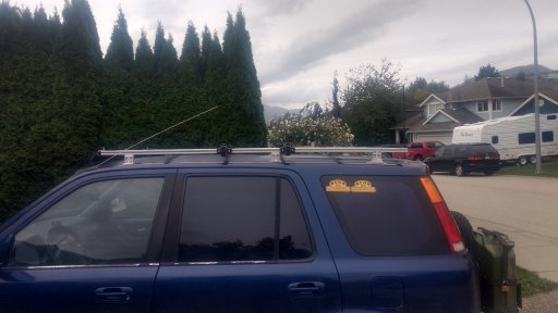

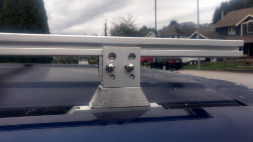

Corrected the upward swoop that my roof rack originally had. It occurred to me that instead of redoing the foot with 3/4 instead of 1" aluminum tubing, I could just drill new holes for the side bracket. It now has an ever so slight downward bow, but way more level than it was before. I'm happy with it.

Looks like a fix !

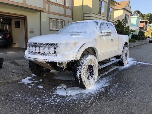

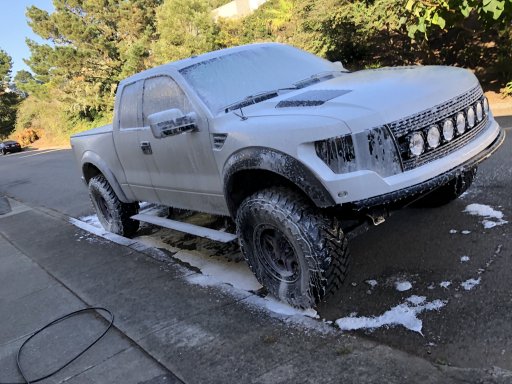

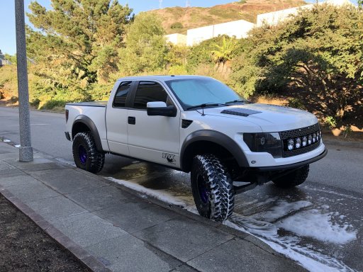

I gave my truck a quick bath with the new power washer and foam gun.
it could a touch up but I wanted to get the dirt off and use the new power washer/foam gun setup.

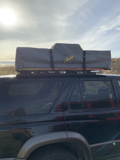

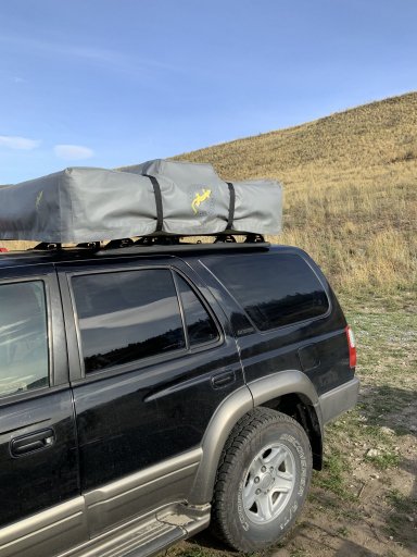

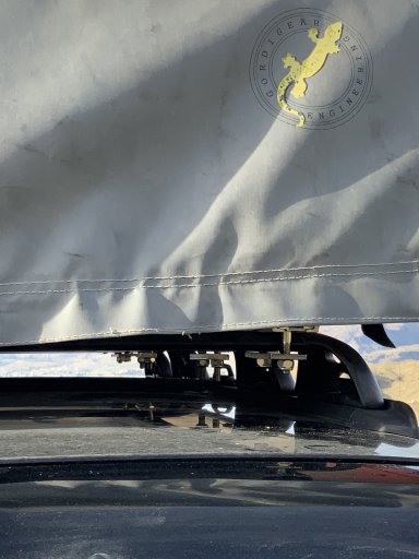

Had this Gordigear RTT on my 99’ 4Runner, then on my 95’ Jeep XJ, now this is how the RTT looks again back on the Runner. Will give a long term report as I will be leaving this on throughout the Winter. No noise, at 60+ with 35 MPH head wind! My stock x Two, Roof Rack, seems to be working great! Vance.

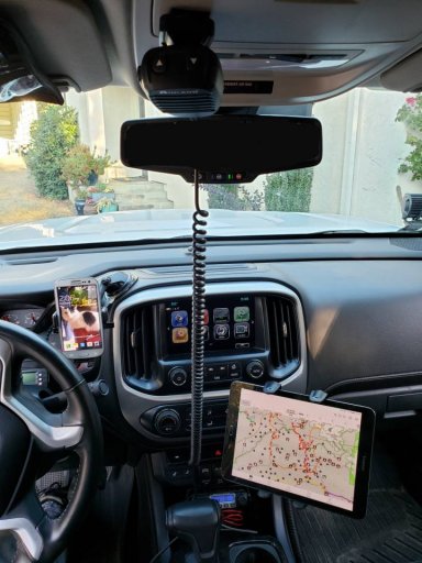

I moved my GMRS mic to the sunglasses holder. I used velcro for 1 trip to see if I liked it better than mounted on the dash to the left of the stereo and it was much easier to grab and replace while driving without taking my eyes off the road. I can also activate it and talk without removing it from the holder. The cable becomes invisible to me after awhile and for daily driving I just unplug the mic and toss it in the center console.827201918813.jpeg

Would be cool if you could put the whole Gaia map in your main screen too.

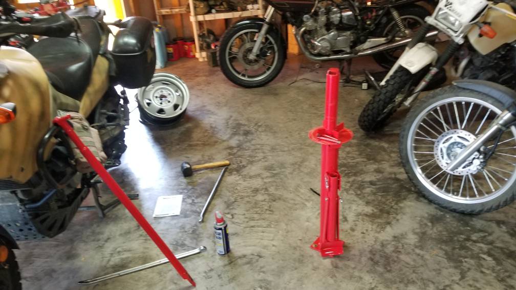

Busted some.tires off the 2 SE wheels I've managed to acquire after installing some drop anchors in my garage for my cheap ass tire changer.
Now to prep the wheels and paint them then scrounge up 2 more.

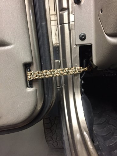

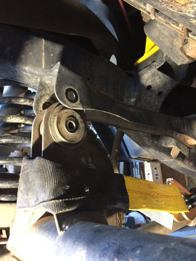

Metalcloak upper control arms today. The axle bushings are still good! Also made new door straps out of 550 cord (after watching Jeep Gear & Gadgets on YouTube). The new upper arms came with hardware. This will enable repurposing one of the OEM 10.9 control arm bolts to replace the thinner grade 8 bolt in the track bar axle mount that is showing some play. Tackle that tomorrow.
