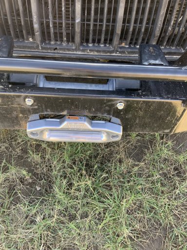

Hello,

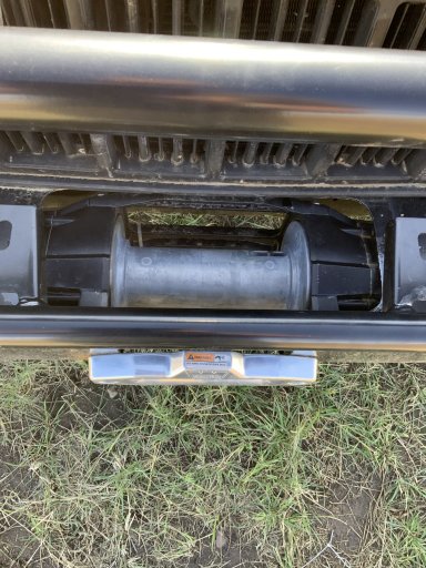

I promised to share some pictures of my mods done to my ARB front bumper.The stock ARB Winch bumper has the winch completely inclosed in a box with no access to the winch spool. Maybe, not so much a problem with synthetic cable, but I still did not like the thought of having to pull the whole bumper to get a stuck cable working again! I wanted to have access to the Winch spool if I ever had a bad backlash or get all the cable stuck on one side of the the winch spool. I think it turned out great. One bad thing, I still need to reach under the bumper to the winch control lever. See what you think? Still need a relocation kit to mount the winch solenoid under the hood.Vance.View attachment 118128View attachment 118129View attachment 118130

Looks very usable to me Vance. Did you have to cut out the bumper from the top to get access to the spool ? How did the winch lever end up on the bottom side of the bumper ? I see now... your winch is bolted to the bumper face instead of to the bottom so that makes your winch lay on it's side. Hmmm I never thought of doing that but did you have a reason for doing that, like no bottom on your bumper. It looks like you welded a winch plate to the face of the bumper for strength, is that true.

I have a bad habit of high jacking posts, so will answer your questions in “ The Daily Thread”. I enjoy looking and learning from DIY mods other post here! Vance.
