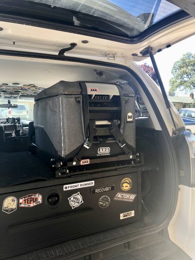

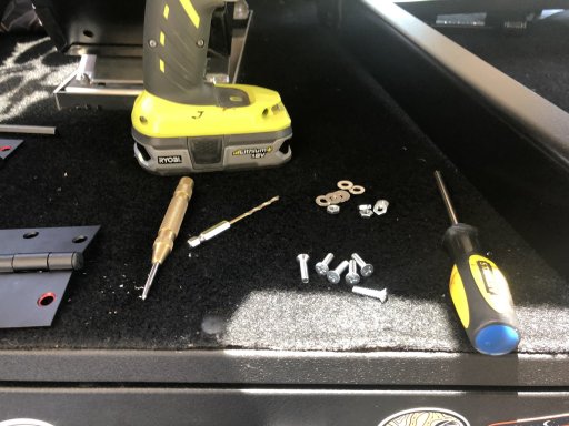

Today I converted my ARB fridge slider into a DIY tilting fridge slider. When my wife and I were at Overland Expo we purchased a new ARB fridge and slider. As soon as we got them back to our rig we figured out what we really needed was either a tilting slider or a drop down slider. Since then I've priced both types and I just can't bring myself to spend between $500 to upwards around $1,000.00 for another slider.
I got onto the internet and looked at how most of them Operated and decided to make something that will work for me. What I found was very simple, all I needed was a way to create a pivot point in the front of the slider and a way to limit how far the entire unit tilted. It's a very simple fix, a pair of door hinges and a nylon strap to limit the amount of tilt.
I put it together and it works beautifully, ever better than I expected. I might change the limiting strap a little but for now it's good...

Thank you, Alucab $479.00, DFG Same, Clearview $699.00 & MSA $899.00. I can't do it my friend. See how this holds up on a few trips and tweak it here and there.
Go Team Redneck Fabrication! I'm more impressed by that than one of those expensive units.
Does it latch down in the back so it doesn't bounce up on the trail?

That's awesome. I gather these fridges are constructed such that tilting them like that is not an issue?

Doesn't need to be, because when the fridge is pushed all the way back in it stays in place with the weight of the all steel slider and the fridge.. that is a plus!

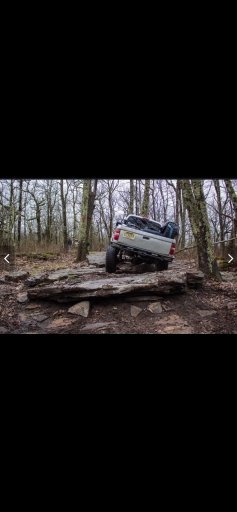

Last day of the work week for me. Tomorrow I’ll be packing and finishing up a few mods before our trip. Spare driveshafts, rear axle shaft, stub shafts, u joints, fluids, tools and recovery gear are already packed. Need to mount the hi lift, re install the cb radio somewhere, buy a couple more tools and pack up our clothes and the cooler and I’ll be ready. It’s going to be a fun weekend! Never been to this trail but the obstacles look like it can present a challenge in a few spots.
Not my pics, but it shows the obstacles pretty well. I’ll be sure to post some up.
