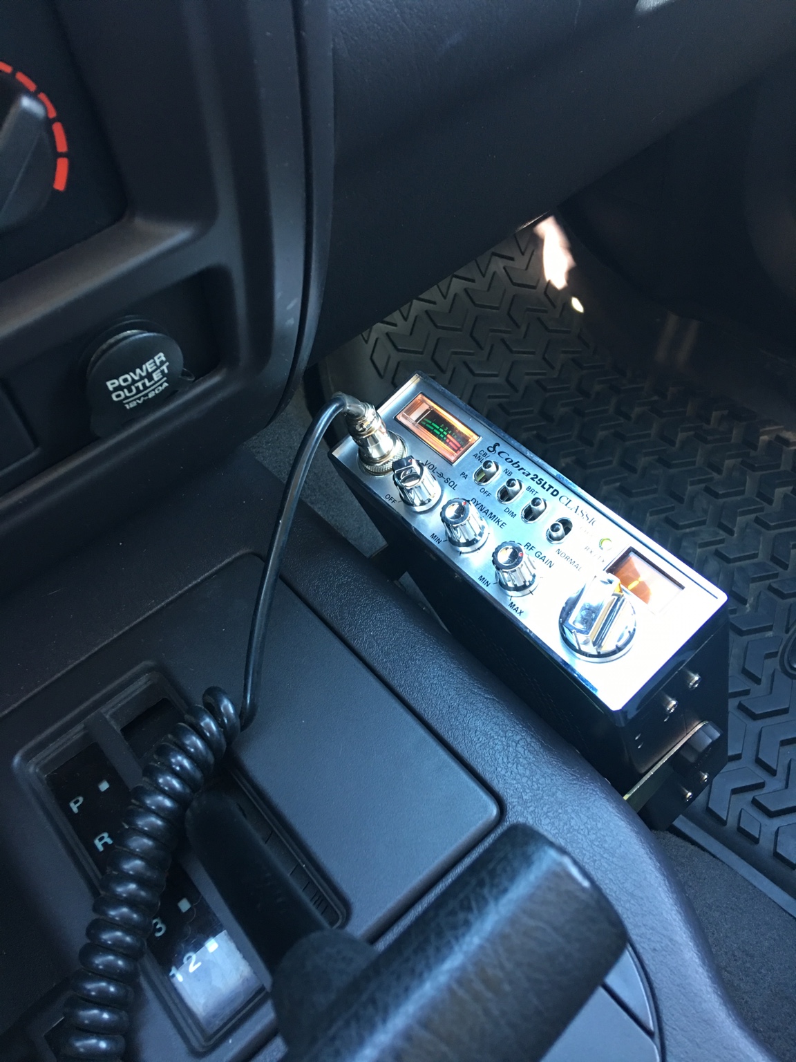

Ran all the wiring and installed the newly peaked and tuned Cobra 25 LTD Classic CB and one awesome Wilson 1000 whip antenna. Best contact so far was 15-18 miles from my location...can't ask much more from a radio without any upgrade mods.
