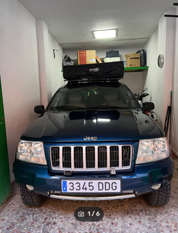

TOYOTA - Land Cruiser 90 3.0 D4D VX 2002 (238 000km) for 13500€
JEEP - Grand Cherokee WJ 2.7 CRD 2004 (190 000km) for 7800€
I like both of them, they are in a good shape, the jeep a bit modified but razonably, the Toyota is stock. Both with A/C, full option, Jeep have leather seats and Toyota no.
I understand that Toyota is stronger, more reliable and you can find part everywhere. But it's all my budget so can not have fail, and will have to wait for prepare it for bigger trips.
The Jeep, I will have 5000€ left to make it more reliable, check everything, buy a rofftop tent etc etc.
Toyota value will not depreciate, when Jeep will.
What do you think? I'm a bit lost but i like both of them. It's lot of money for me and makes it really important.
Thank you for the ones who read me till the end, sorry for my aproximated english ^^Captura de pantalla 2025-05-06 125412.pngCaptura de pantalla 2025-05-05 171341.png

Take the Jeep, WJs are awesome. Drives great on the street and is very capable offroad.
Just keep an eye on differentials and and stay on top with maintenance.
What transmission is in the jeep? Automatic? If so, get it flushed. Maybe get the engine checked and spend some of the left over money on preventative maintenance.
Good advise. And I would just add two ideas if the decision is really just between these two rigs. If the Yota is nearly at the top of your budget I would recommend to go for the much cheaper Jeep and not only save some money for good mainentance and repairs but as well for trips. Plus I always recommend to go with the rig your heart beats for. It will not make you happy if you just buy a rig because people say that it is the right one for you. No, it´s essential that YOU are happy with your decision.
Also, check for 4x4 guys in your artea. There is a hughe community in Spain and also around Valencia. And then ask someone to accompany you who is experienced with the rig when buying.
Enjoy!
