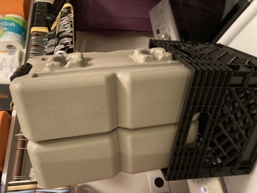

I'm trying to get a sense of whether two of these stack well in a long standard milk crate.
I'm specifically wondering if the interlocking ridges interfere with the fit. The posted dimensions suggest that two could lay side-by-side in a crate, but I can't tell if they include those ridges when they say 6"
May someone please post a picture of two bricks stacked side-by-side in one crate? Alternatively, can someone post the real dimensions of one unit?
Thanks,
I’m not entirely sure of what you’re after but I have a long milk crate and 2 bricks. I don’t think this will work well. You might get them in with force but getting out will take a full out recovery job! Ridges definitely cause the issue, but length or width slightly too long also. I don’t think even the half bricks would work. Hope this helps.20C52AC5-E0F6-43C5-9414-5F47A12DB219.jpegCA4A184E-8827-4921-BE0C-D28318425C03.jpeg20C52AC5-E0F6-43C5-9414-5F47A12DB219.jpegCA4A184E-8827-4921-BE0C-D28318425C03.jpegF8ADE70F-D663-45DE-BEE0-02F83CB6935D.jpeg
