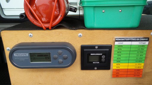

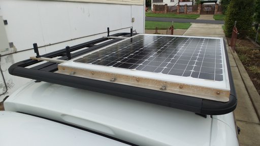

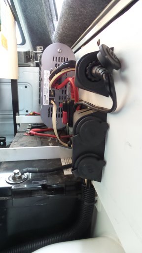

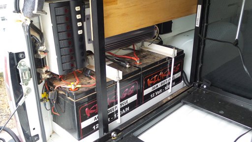

I do not know if this is what you are after, but this is my setup.
I have a 200 Watt fixed solar panel mounted to the rhino platform on the canopy.
Which connects to a RedArc 15 Amp battery management system.
That charges 2 x 120 Amp/Hour deep cycle AGM KickAss batteries.
I can monitor the batteries via the control panel.

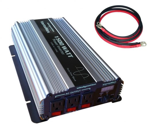

Glenn - Curious why you chose a modified sine wave inverter over a pure sine wave inverter. Aside from cost, I can't think of any reason not to go with a pure sine inverter.
Not knowing the difference between them, I did some reading. This below convinced me to forego the added cost since none of this applies to my needs...
"In short, pure sine wave inverters are better suited to sensitive electrical or electronic items such as laptop computers, stereos, laser printers, certain specialized applications such as medical equipment.
Modified sine wave works well for most uses, and they’re more economical. If you mostly want to run lights, TV, microwave oven, tools, a modified sine wave inverter is fine for your needs."
So after looking around I could not go wrong with the Kreiger (quality name brand) that also came with 3' cables and some silly remote :smiley:

Well, the other advantage to PSWI is cleaner power, all devices run better and cooler. PSW is what comes out of your wall. TVs definitely run better on PSWI, less background noise. With MSWI, you'll see and hear noise from the 'dirtier' power.
There are decently priced PSWI products out there, but you do still have to pay a bit more up front, but if it means longer life for your devices, then your TCO for everything should be much less.

That is a nice setup. I see that its permanently mounted and Im not quite thinking that a permanent setup is right for my rig but I love to see the different ways we all use. Im interested in your power switches and how they are mounted right where you drop your gate and accessible. Very kool and unique. Are they all wired and dedicated to lights, devices? Im torn between a portable case for all my solar equiptment OR mounting the inverter/controller/switches permanently in my jeep and only making the batteries/panel portable. Your rig and mine are apples and oranges though but I love what you did !
G'Day Glen
I thought you wanted to be portable, that is the reason I did not originally post photos. I posted the photos to try get the ball rolling for you, hoping there would be more setups too come. :smile:
I used a 12 Volt 6 gang switch panel, I purchased mine from eBay. The reason I went with the panel, each switch is already wired with its own fuse. I can access the switch panel from the rear of the vehicle when I drop gate. But also accessible from the side window on the canopy.
It is wired to the following...
1. Canopy Interior light
2. Water pump
3. Rear external LED light
4 & 5. 12 volt power socket inside canopy
Fridge runs straight from battery (fused) with no switch.

I want to thank you so much for asking the question about the Modified Sine vs Pure Sine ! I looked into it more after what you said in your post and now I am left wondering why ALL inverters are not made pure sine now? I saw 2 videos last night on Youtube that guys has comparisons on how different devices compared running on each and I was amazed. The differences were incredible.
Consequently I already have a return shipping label made for when the Kreiger arrives and last night I ordered the Windy Nation Vertamax 1500w with 2 cables... THX pl626 for setting me straight !! :smile:
NP. It's tempting to just look at the initial cost difference, but all things considered, pennies saved upfront can add up to huge replacement costs in other equipment.
MSWI do serve a purpose, but if you want to run expensive hardware/tools, it doesn't really make sense to be penny wise, but pound foolish, just my.02.
I couldn't justify the extra cost until seeing a couple videos... they are WAY different. Some devices actually made strange noises on the modified...that's a hell no ! Well...back on track now !
