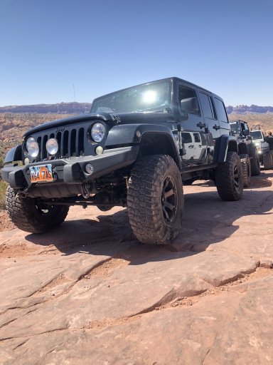

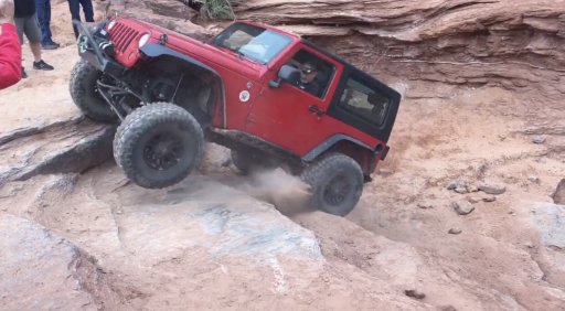

I saw you wanted to got and explore Moab. I’ve been going to Moab every year since 1987 and have seen a lot of changes in Jeeps. There really isn’t to many trails you can’t do in JKU running 33s on stock axles with us mild lift. The only thing on a JKU is you have to watch IMG_0580.JPGIMG_0341.JPGthe break over angle because their so long. I run 35s on my 09 JK with a RK 2.5” Max Travel list. It’s an X so it has the 30 in the front and 44 in the rear. Other than running an Aussie locker in the front and a ARB in the rear with 5:13 gears its stock. My plan was to replace when the 30 broke but it’s still going. If you go over 33s than you will need to re gear with the auto is a slug. I overland with my 2012 JKU its running 37s on stock 44s with c gussets only. I light on the pedal so it’s holding together so far. I am upgrading to 60s next year. Both Moab and Colorado are great places to explore in a Jeep.
