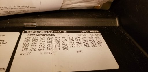

OP is the second owner, as she got it from the original owner. I bet its still there :P
this is what it looks like for ref, inside the glove box.. This is from our truck. codessssss.jpg
this is what it looks like for ref, inside the glove box. View attachment 131508
Good chance, it does say DO NOT REMOVE ! Need something (code book) more than this to get an answer.

yep! for our truck the codes "g80" and GT4 tell us that it has a G80 locker in the rear and a 3.73:1 rear end, as well as a LM7 engine, etc etc etc. Its nice.

Justin, was yours z71 or no? did you have the max tow package?
Max tow and z71 both get lower gears and g80s, our 2wd has the max tow which gave us 3.73 and a G80 in ours. I think the gear ratio breakdown is in the manual, I'll have to dig it up but im like 99% sure she's gonna have 4.10's
I honestly don't remember. It was a Z71 but had cloth interior so it wasn't fully loaded. I don't even remember if it had the G80. I just remember the sound it made when smoking Mustangs and Subaru STis at the strip or stop lights. :tearsofjoy:

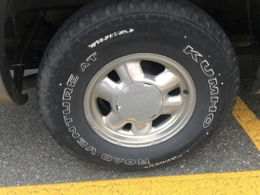

Hi Everyone, who has replied or is following this thread.
After taking into account everyone’s advice I have decided to make the journey west from Toronto and back on the same size tires and wheels and make slight adjustments for the weight of the camper once it is on and then in the summer change the tyre and wheel size. Yestertday I went and got the truck serviced at my trusted mechanic and he told me that I should stick with the existing tire as it has lots of tread on it and to save the money. My only dilemma is regarding travelling across USA with A/T that dont have a snow rating but have good tread. I will be carrying snow chains. Any thoughts on this is as always appreciated.
I see nothing wrong with that decision and in fact suggested that is what I would do in my first post. As far as I can see your tires look to be in good shape if the pic is a current one. Between your 4 wheel drive, snow chains and careful driving you should not have any problems. Snow rated tires pertain to the tread design not the tire itself. AT tires are all heavy duty unlike passenger tires.That stock truck is capable of anything on a hi-way situation or even maintained dirt roads if your driving skills are adequate. If I were you though I would weigh the truck after you put the camper on just so you'll know what it weighs.

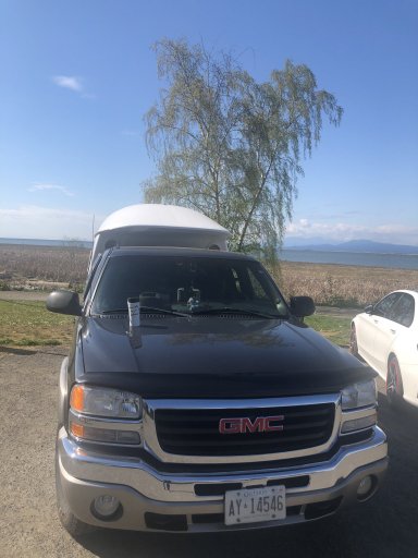

Hello to everyone who previously helped on this thread, it seems like a long long Time ago I posted this question and it was a great learning curve for me then and its still is now but i am in for the long term and willing to learn.
I hope everyone is well and so are your family and friends at this challenging time!
I made it over to Port Townsend in one piece and enjoyed 3 months sleeping on the rear seat of the truck while building my tiny overland house, good news I am now living in my Tiny Overland House (see attached photos!) and currently self isolating in Vancouver, I made it across the border with 2 hours to spare!
I have been continuing the rig build build in Homedepot parking lots and getting there!
Here I have continued my build and I am currently preparing for a trip across canada back to my family and now need your expert advice again!
My question is:-
The old tyres did make it across the USA! However they are now showing signs of wear and tear with small areas (Spots) of rubber disappearing on my front & rear right tyres (please see attached photos)
So I am now looking to change the tyres for my BFG Ko2’s, the question is should I change out my Shocks and add a leveling kit at the same time. I was initially going to just swap the same tyres 265/75/16, however the technicians at KALTIRE in Coquitlam suggested replacing the shocks and adding then level kit. They are recommending the following:
Monroe Reflex Light Truck Shock parts numbers 911501 & 911502 = $1184 CAD
I also indicated a desire to increase the tyre size and they have suggested they could install a BFG KO2 275/70/18 for $2131 CAD and make a trim on the front wheel well/bumper to avoid rubbing on full turn.
They are recommending Truxx leveling kit - $600 CAD
Total spend approx $4284
I look forward to hearing what you would do?
