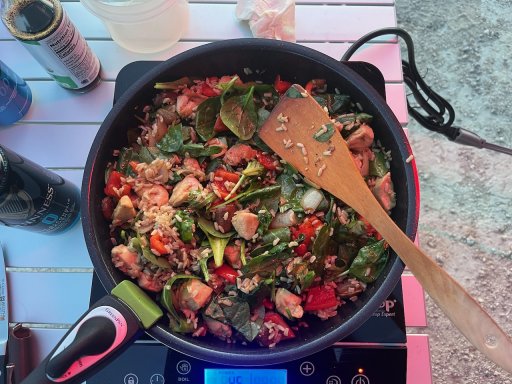

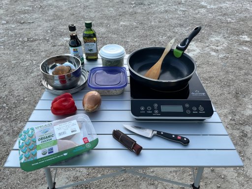

I've given up on gas stoves. Just not my thing, dealing with wind, open flame, refilling bottles or using throwaways, ... it's just not for me. So, I use this setup now:
And just now working on installing a 12V travel oven to add a secondary way of heating things or keeping things warm.
Results have been pretty good so far ...

Sorry, didn't mean to make this in any way "click-bait" or "tricksy".
I guess it depends on the definition of overlanding. We are driving pretty much every day, have 200Ah batteries in the truck and re-charge with up to 55A. So, a max of four hours driving is good for a full charge. The dinner shown in the photo above (overall about 30 minutes cook time on the induction top), some runtime on a 900W electric heater (not long, just to heat the tiny cabin of the Alu-Cab Canopy Camper), hot coffee in the morning, lights, and some phone charging got the batteries down to 65% or so. That was re-charged in a pretty short time on our way to the next camp (and that 65% number is from memory, I actually think it was better, but haven't written it down anywhere – a typical fully cooked meal is about 20 to 30% of our battery capacity).
I got so sick and tired of gas bottles and overpriced stoves. And your equivalency numbers are useless as they don't account for efficiency of energy use. Even a home gas stove has only 1/3 efficiency compared to an induction top, a camping stove in the slightest wind drops to even lower numbers to the point where I've seen it being barely usable even on high power.
