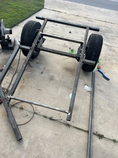

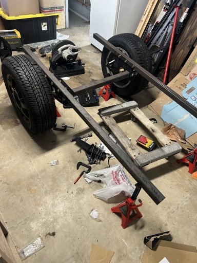

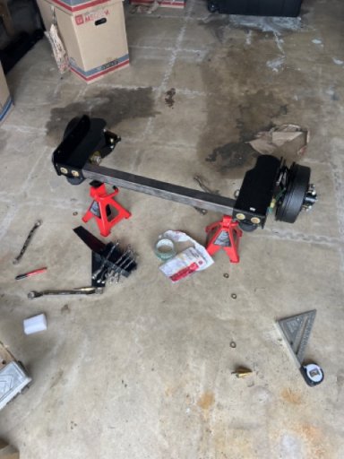

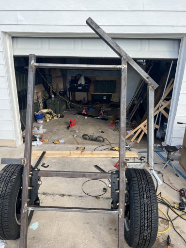

Getting somewhere... Mocking up the Timbren Axles gotta hit up the ole metal supermarkets.

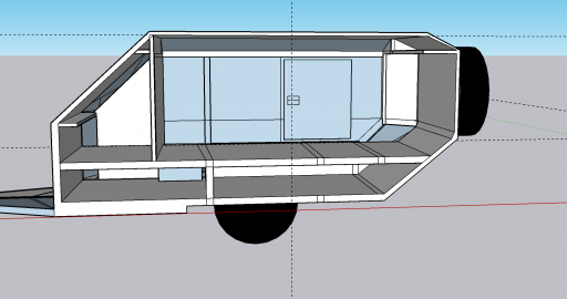

Sketch up has become quite addictive while I wait for materials to arrive.
