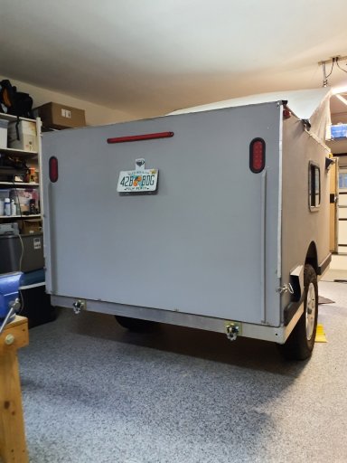

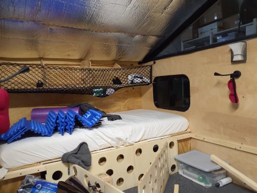

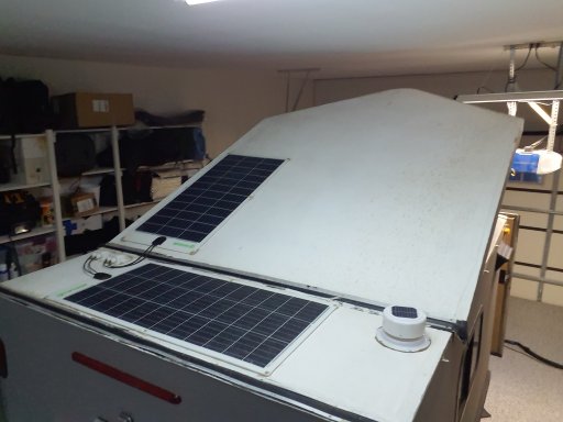

I built a modified Teardrop trailer
Body 10 ft long(including bullnose), 4 ft sides, 6 ft wide (tires inside the wall). I used a Northern Tool trailer kit, plywood sheathed in PFG-(poor man's fiberglass). Rear 2 ft - kitchen- 3 burner propane stove, 12 V electric system for interior lighting, water pump, refrigerator/ freezer, 200 watts solar, power pack(60 AH) and storage space. Inside, 30 gal water tank under the bed, 14 inch, wall to wall shelf over foot of bed, roof opens so we can stand up in bull nose area. Hi-clearance Timbren suspension with off-road spindles, electric brakes and 17 inch Jeep wheels. 20 lb. Propane tank & spare tire mounted on tongue and Lock & Roll off-road hitch. See picture in my profile
Very cool. Where can I see it in your profile? Id like to check it out.
The background picture at the top. If somebody can tell me how to upload pictures I can send add'l pictures

Quick question, what is your ground clearance? Also, have you put a lot of weight on your roof?
Not sure on the ground clearance but I've gone through some moderate rocks without issue and I can walk on the rear half my roof. I built the rear half of the roof to be able to support a low profile rack and the front with less support because it just holds my solar panel
