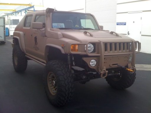

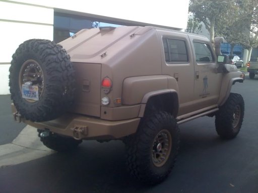

OH, Tinker, I may have made a mistake, I think Chris' H3 may have been an original 5.3 Alpha..? Or he mentioned doing the swap..? I can't remember where to look that up now, I apologize for the mix up, my memory is shot... Maybe he was referring to the guy that did the REALLY COOL, tan, slant back conversion with Duwayne from Boyd Coddington's old shop... He's a great guy to talk to also. Out here is a guy who has done a lot of research, and wheels a lot. The name he goes by on the internet is "Shwartzy". Actually, as I read all of what I just wrote, it may sound like I know them, but I've only ever just messaged them back and forth. I think I have a picture of the slant back "Recon H3", I have a ton of screen captures of his build...

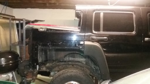

Thank you Montaska, I'm so ready to get back in and get to work on it, I'll be sure to post pics for y'all this week as I get back to work trimming sheet metal and drilling out the factory spot welds where I trimmed off the roof...
I was trying to get the little Tig welder to work on some practice pieces of the roof section I'd cut off the rear, but it's so close to burning through, I may just pic up a little mig welder this week, and my gloves are missing..(that's weird..? Now I've gotta look in the dog's hiding spots...)
Hang on one second, I'll grab a better picture of what I mean...
H3Coyote
1,080
MidWest, U.S., by Chicago.
10290

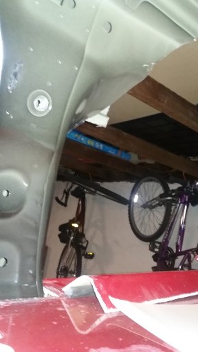

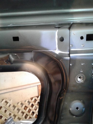

Okay, here's where I'm at, you can see the extra sheet metal I left on the rear where I cut seems to be WAY too much from the outside, but, on the roof are some stamped areas that all have to be matched back up, blend fitted, and welded.
So I want it look as "factory" as possible when its finished, and for me to do that kind of work is a new thing with thin sheet metal.
The part I mentioned earlier, the spot welds you can really see well in these pictures just inboard of the forward panel, next to the rear door.

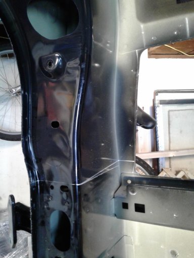

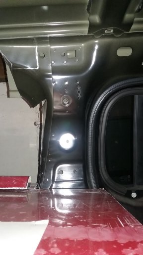

From the inside, it makes me think this rear panel area was almost a second thought add on piece from the factory..?
I first noticed that following Rod Hall's H3 desert racer build when they were posting pics of his internal rear cage...

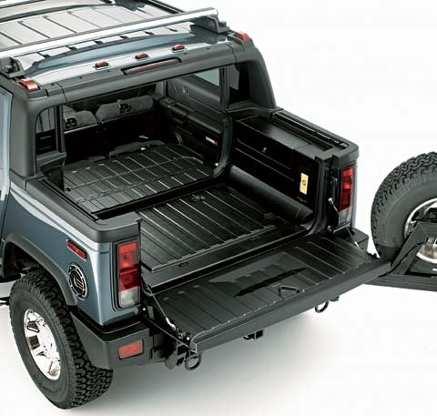

This is the goal that I'm shooting for...
A completely open pass through cab area similar to the H2 SUT, it reminds me a lot of my old 4 Runner, Bronco, and K5, when the top is removed.
But with a removable hard bed cover, the "soft top" will be only on the rear wall, above the level of the "bed area" like the original M998 hmmwv. A fold down (into the cab) rear wall from some aluminum tread plate I picked up last week. And an actual drop down tailgate I'll have to build from the original rear door.
