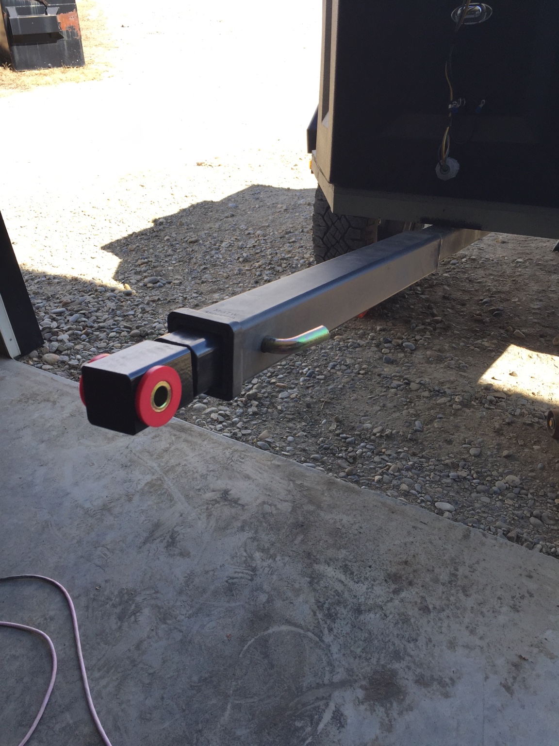

Very nice work!! I am building a trailer also and I was wondering about your trailer tongue length. How far is it from your vehicle to the structure on your trailer? In other words, what is the steepest angle you can go through (like a ditch or creek) without your trailer contacting your vehicle? Hope I explained that correctly......

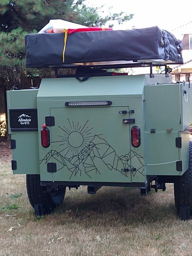

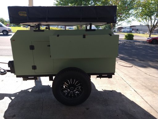

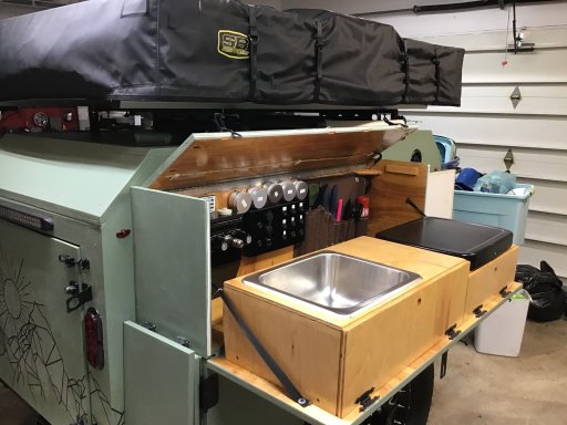

With the increase mileage on my JK and the lack of fuel economy, it was time to build a full overland trailer. You see, my JK is my daily driver and having the RTT on the rack does not help. I've been thinking of a complete rebuild on the current offroad trailer I had which followed me to Utah, The Yukon and Alaska. Having the wife join me on our big YK/AK trip, she determined that the trailer was not practical. So, with some input (yes, she can come up with great ideas from time to time) it was back to the drawing board.
Just want to thank you Chappy for the inspiration and the design. I added a few of my own ideas to my build but I would not even started if it wasn’t for you photos and videos. Much appreciated. See you on the trails..Regards member 40029
