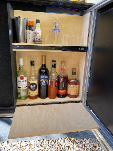

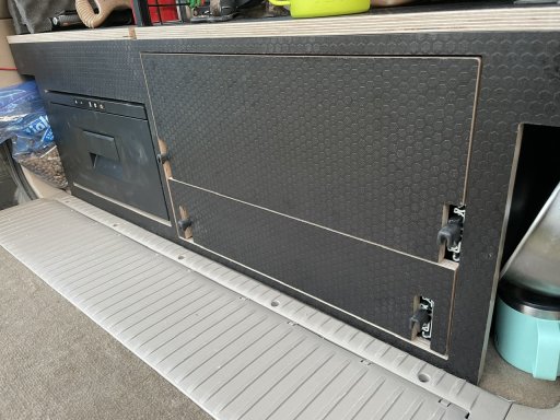

Finally got the lift up lid done. Learned lots about their function, limitations. Really happy with how it turned out. Thanks again for the inspiration!
looks great! Nice little unit. Those lifts can be more challenging than one expects for sure
Nice work! I love the look of the side panels.. like a Topo map.
That is wood with a sort of white wash paint i guess? Awesome build man!

Thanks.
Dave has been really selfless, and not only made this great forum thread, but privately gave me some guidance.
All the wood is Baltic birch, amazing product. The panels are 1/4” and have five plies, the top is 5/8” with eleven plies. Very similar to marine grade plywoods. Then a light stain, and four layers of poly! Really nice wood to work with, you get that skateboard deck look on the edges that are visible too.

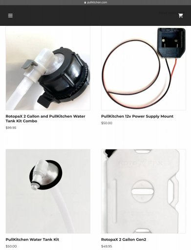

I definitely don’t want to cross a line with OLB but PullKitchen just added some unique products for sale that can help DIYers.
View attachment 200864View attachment 200865
I’m not saying you need a PullKitchen hat, but you may want one :tearsofjoy:
Hey Dave
I ordered the hose and cap for my rotopax from you guys ! - the submersible pump i got with the sink / and gas burners doesn't fit into the rotopax are you using a self priming pump now ? if so which one are you using ? will pop up some pics of my draws soon in my 200 lc inspired by your design !

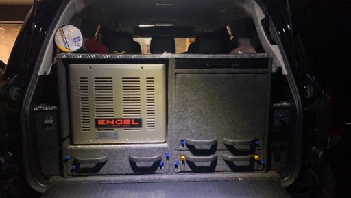

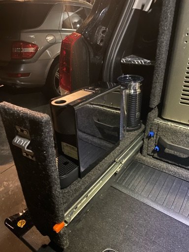

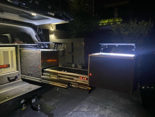

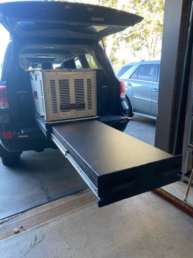

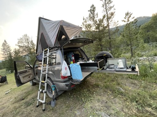

Hey Dave,
I loved your concept so much I built my own to suit my new lc200 - haven’t finished it yet but love it os far !
I order the rotopax cap / hose and external pump from you this week cant wait to get them !!!
Your concept works in the cruiser without removing the back seats I just had to make the cutlery draw and pantry 500 mm long each MAX (actually about 490mm for 1 and 500 for the other) and i used 4 pairs of sliders for the draw system.
1 meter for main slide 2 x 300 ( 1 pair at the rear non lockable and front lockable) and 1 500mm 125 kg (the others are all 225kg runners)
Thanks for sharing your details they helped me heaps

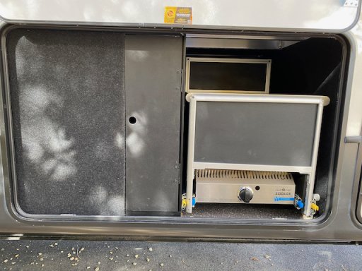

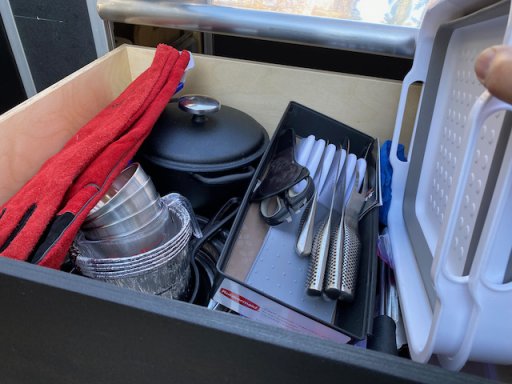

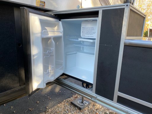

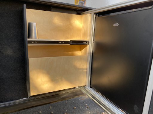

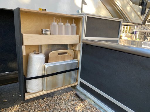

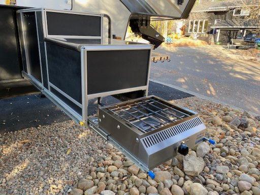

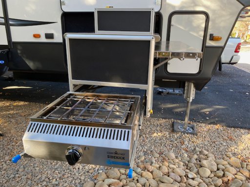

Like many others, I was greatly inspired by the PullKitchen threads that PapaDave has posted here, and all of the details that he shared made my project seem possible. I hesitate to post here, as my slide kitchen is for a 5th wheel RV. But, PapaDave has graciously encouraged me to post them here, so here goes!
As noted, this is a kitchen for a 5th wheel RV, and it installs into the main storage bay opening on the curb side. It is 24" wide, 29" tall, and rests on 60" long drawer slides.
The goal was to have an outdoor kitchen and an outdoor bar area. I used a 24x24" stainless top from a restaurant table, and a 12x48" stainless shelf on pop up hinges. The frame is 10 series aluminum extrusion (Faztek Canada), and 1/4" baltic birch finished with black paint then a coat of rattle can black bedliner.
There is no water or sink yet; I will be adding RV outdoor taps with a quick connect spray hose (just inside the storage bay) and will use the 2 foldable tubs that I store in the main drawer.
The stove is really interesting; it is a Camp Chef Sidekick. This is designed to attach to the side of some of the Camp Chef pellet grill models, but I riveted 24" drawer slides onto it to mount in my kitchen. It has a really great burner, but the cool part is that it also has options; a griddle, a BBQ sear box and a Pizza oven! I have all of the options and they store in carry bags to the left of my kitchen (behind the door there)
View attachment 213006View attachment 213007View attachment 213008View attachment 213009View attachment 213010View attachment 213011View attachment 213012View attachment 213013View attachment 213014View attachment 213015View attachment 213016View attachment 213017
I hope this is helpful to others in your projects. Let me know if you want more info; PM if you like so it doesn't clutter up this thread.
Thanks again, PapaDave, I really would not have been able to design and build this without your inspiration!

Hey Dave,
