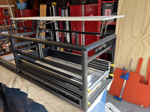

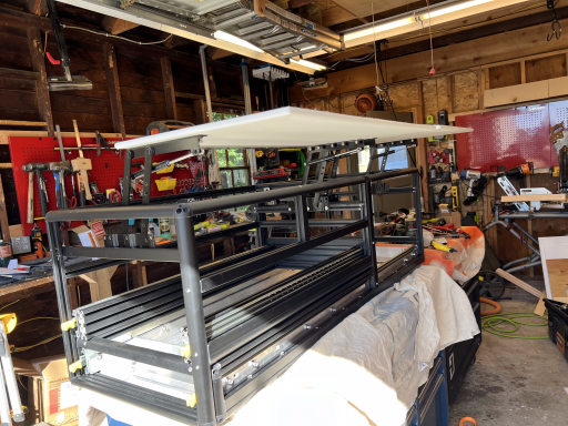

Thanks for all the inspiration in this thread. Due to all the work you shared, I scrapped v4 of my kitchen build, and went all-in on an aluminum extruded version, inspired by yours. Got it mounted in my truck yesterday. Still have a lot of little tweaks to do, but its getting there.
Well unfortunately the company is no longer producing PullKitchens so you’d have to DIY it based off the info here.
Now that is rad!! I love it! Especially incorporating the fridge in the rear, really cool design!

Yeah, working with a short bed midsized truck, but wanting to keep it all in-line, I had to incorporate it into the slide. It actually lands in a great spot, where my kids can reach it easier, with a little step stool.
That’s really cool! Thanks for sharing your work!!

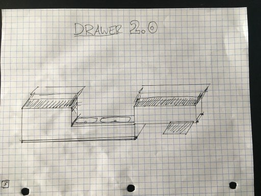

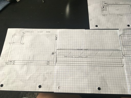

What I have are those “blueprints” on the first couple of posts. My suggestion is figure out the minimum required for whatever sink/burner units you want to use and build around that. Whether the sink and burner are separate or integrated together like the Dometic 9722 I used. The depth of a sink (if you have one) with a drain can affect how tall a design can be in its minimum space requirements. Or how wide or deep.
Once you have that unit(s) figured out you can begin building the rest!

I see the design pages aren’t there anymore. This is all I worked off of. For extrusions Tnutz is a good choice, items you can’t find there try 8020.com, and have them cut and tap. It will save years off your life

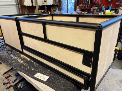

Glad to hear your design is meeting your needs! Remind me what it looks like, got any photos?
Reactions: kowbra
Wow you’ve made great progress! Nice work it’s looking good!
