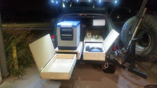

Now that i have fridge for my truck, I was needing a better way to get into it. Ive also been wanting to build some storage drawers to help keep more of my camping supplies, tools, and recovery equipment more organized. What i came up with works very well.
I decided to build 2 integrated tables into the system with tops that would open up for storage below. There is also a slide out for the fridge. I do plan to go back and remake the left table into a 6" tall vs 4" tall drawer, and make both tops out of a cutting board instead of MDF. Im also going to go back and replace them with locking slides to make sure they stay open and closed when i want them too. One other thing i noticed while using this last weekend in the ozarks, is that the left table would sag down when items are on top of it. I dont have room anywhere in my gearset to add table legs, but found that my hiking poles work perfectly to put under it for extra support.
One other thing i did was install some LED lights into the rear hatch trim panel to light up the kitchen area when cooking in the evening/night time. I ordered these off amazon to light it up. The wire on them is something like 24 ga and is very thin. It made it a bit of a headache to wire it all together into one main power and ground wire, but patience and persistence paid off. I also added a toggle switch to manually turn them on and off. I was thinking about an automatic switch, but decided that i didnt want them on all the time while the hatch was open.

the left "table" i want to remake into a 6" tall drawer, and also upgrade all the slides to 500 lb lock-in/lock-out slides. Also would like to do some sort of "top" on the tables thats better for food prep. Most likely will try a 1/2" hdpe cutting board material instead of the MDF

they are supposed to be 9w each, and there are 12 of them. One of them was DOA and i never bothered to measure the true wattage of them. However, they work excellent for what i installed them for. They work great for kitchen lighting, map lighting, or anything else i would need back there. The best part is, with there being so many light sources, there is absolutely no shadow to be seen in the working area.

ive never had a issue with my lights getting hot at all. ive had them running for well over 2 hours and they were stil able to be touched. they were a little warm, but you wont get burned by them or melt any plastic where they are mounted. Im very impressed with them for the price i paid.
I might put some interior lighting in with some of the LED strip lights in the cargo area.

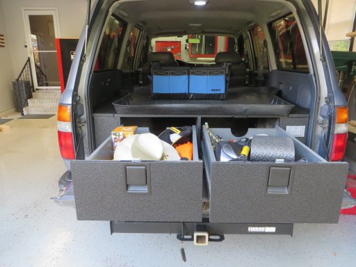

not sure why its not showing up at all, but here is my setup. Its a double slide out with a table top and storage, and the right side is a single slide out with storage in it. Thats a 50qt arb fridge.
In the left drawer, i keep my coleman stove, a backpacking stove, a good knife, and some propane. The right drawer is where i keep my plates, pot set, skillets, utensils, spices, and more.
