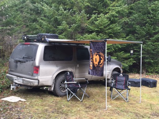

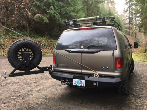

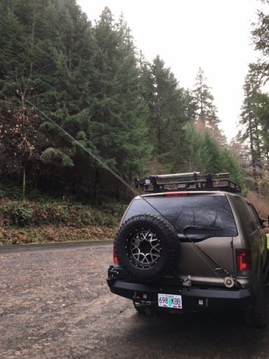

I can relate. While my situation was a little different, I initially wanted the spare out of the rear compartment for space considerations because we sleep in the back of our excursion and the spare impinged on that area. I upgraded tires and rims, and the 34's no longer fit in the original spare compartment so up on the roof rack it went. Bad joojoo. All 135 lbs of spare made my center of gravity taller to where I could feel it in corners and to bring down the tire in the event of needing to change a spare was a real chore requiring a stable ladder to do it safely. When was the last time you travelled with a ladder? So I found a local bumper company to make a rear bumper with swing arm for the spare, oh and added a rear winch as well which is awesome!! This made a world of difference.
View attachment 42688 View attachment 42689 View attachment 42690

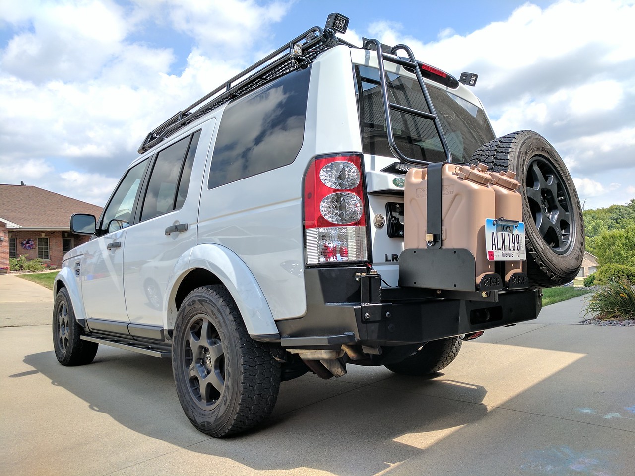

On Land Rover LR4s, you can slightly deflate a tire around 32" and still fit it up under the rear, but beyond that, a tire swing on a bumper.
I only put my tire and jerry swings on for trips, so the rest of the time its crammed up under. :D It sticks, but a few good kicks and the tire winch and its in!
