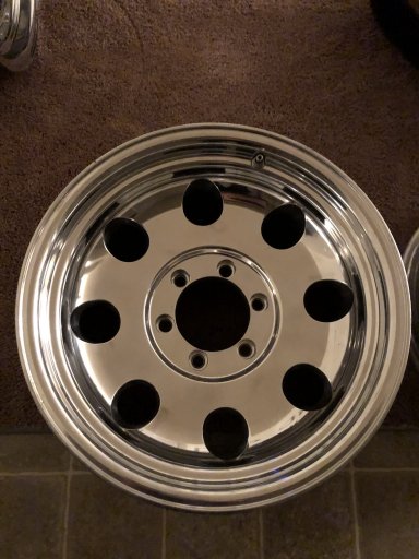

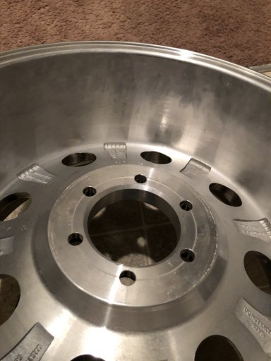

So the 17s taipered down to like 15 in the center?
804Tacoma
271
Charlottesville, VA, USA
F
22345
I'm not quite sure what you mean to be honest, so I provided a pic of the front and back of the wheel. I spoke with a gentleman today who described the wheel face as not having enough of a "scoop". It doesn't make a whole lot of sense to me but all I know is that they didn't work for anything lol.
