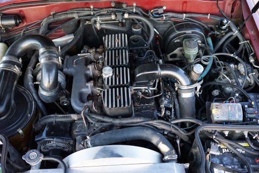

  • 4BT Cummins 3.9L Turbo Diesel w/ 47RH Transmission (approx 176k on motor, 20k trans)
  • New Holset HE221W Turbo w/ Billet wheel - Boost up to 22psi

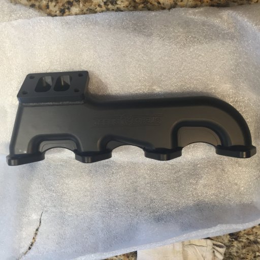

  • SteedSpeed Exhaust Manifold
  • Prince of Darkness Injectors

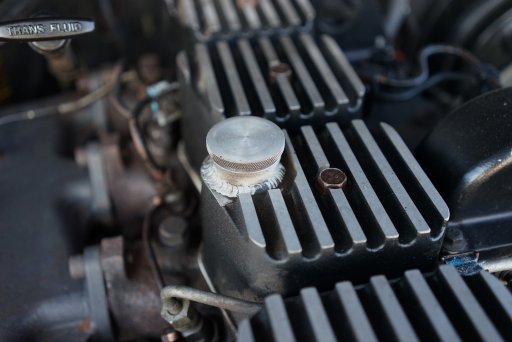

  • BD Cool Valve Covers

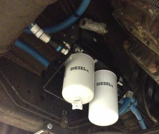

  • Replaced Mechanical Lift Pump w/ Air Dog II 100g/h Fuel pump with water separator and fuel filter

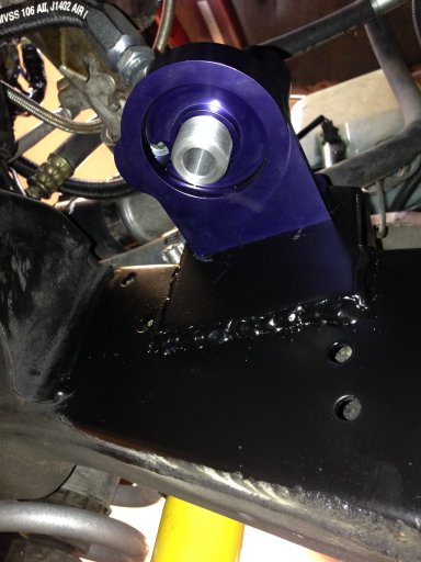

  • Remote Oil Filter Relocation
  • Billet freeze plugs
  • New Fluidampr Harmonic Balancer

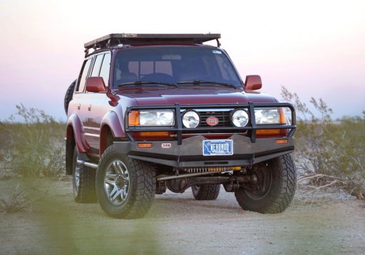

  • ARB Front Bull Bar Bumper

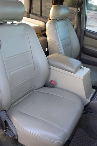

  • Manual Front seats reupholstered
  • 8" Tuffy locking center console (custom welded & matching leather armrest)

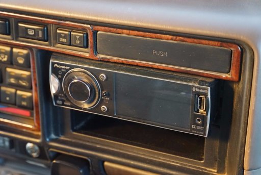

  • Pioneer BlueTooth USB Head Unit & speaker upgrades to 6.5 Rockford Fosgate all doors

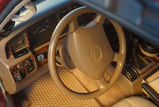

  • Triple A pillar pod gauges: EGT, Trans Temp, Boost, Fuel Pressure, Water Temp

  • Aluminum performance 3 row radiator & Intercooler
  • New Mechanical Fan and Fan Clutch - this was the secret sauce to make 4BT swaps run well in the desert, AFAIK I am the only Landcruiser with this set-up, designed by Local Race Shop
  • New Water pump and Thermostat
  • Aux Electric fan that is Auto temperature controlled
  • This thing stays around 185F unless hauling uphill w/ AC on.
