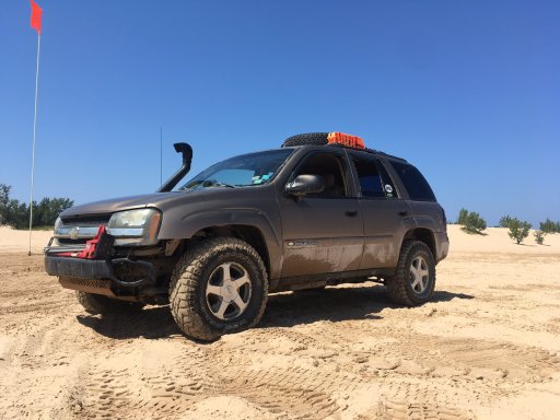

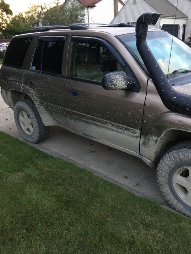

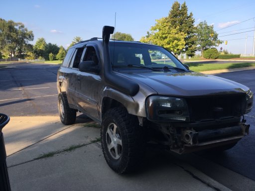

I personally ordered one, it doesn’t match my body lines and is kinda ugly. But it saves my engine. My air intake is right behind the passenger headlight facing forward.IMG_0028.JPG
