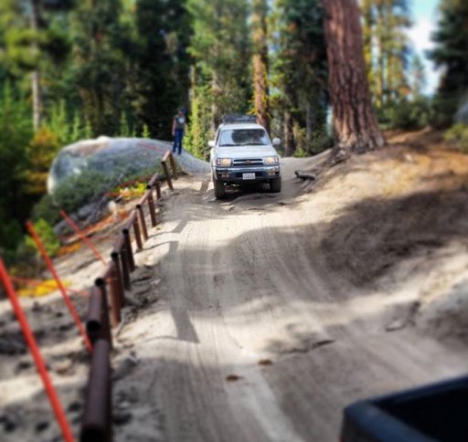

@Mad_Garden_Gnome I hung out with the reps from Wilco Off-road a lot during the rally. I'm looking into a disconnect but it isn't too high on the list. With the new setup, the truck did awesome and obstacles I didn't think I had a chance on, went right on by without a pause. I think the next couple mods will be armor and organization.
