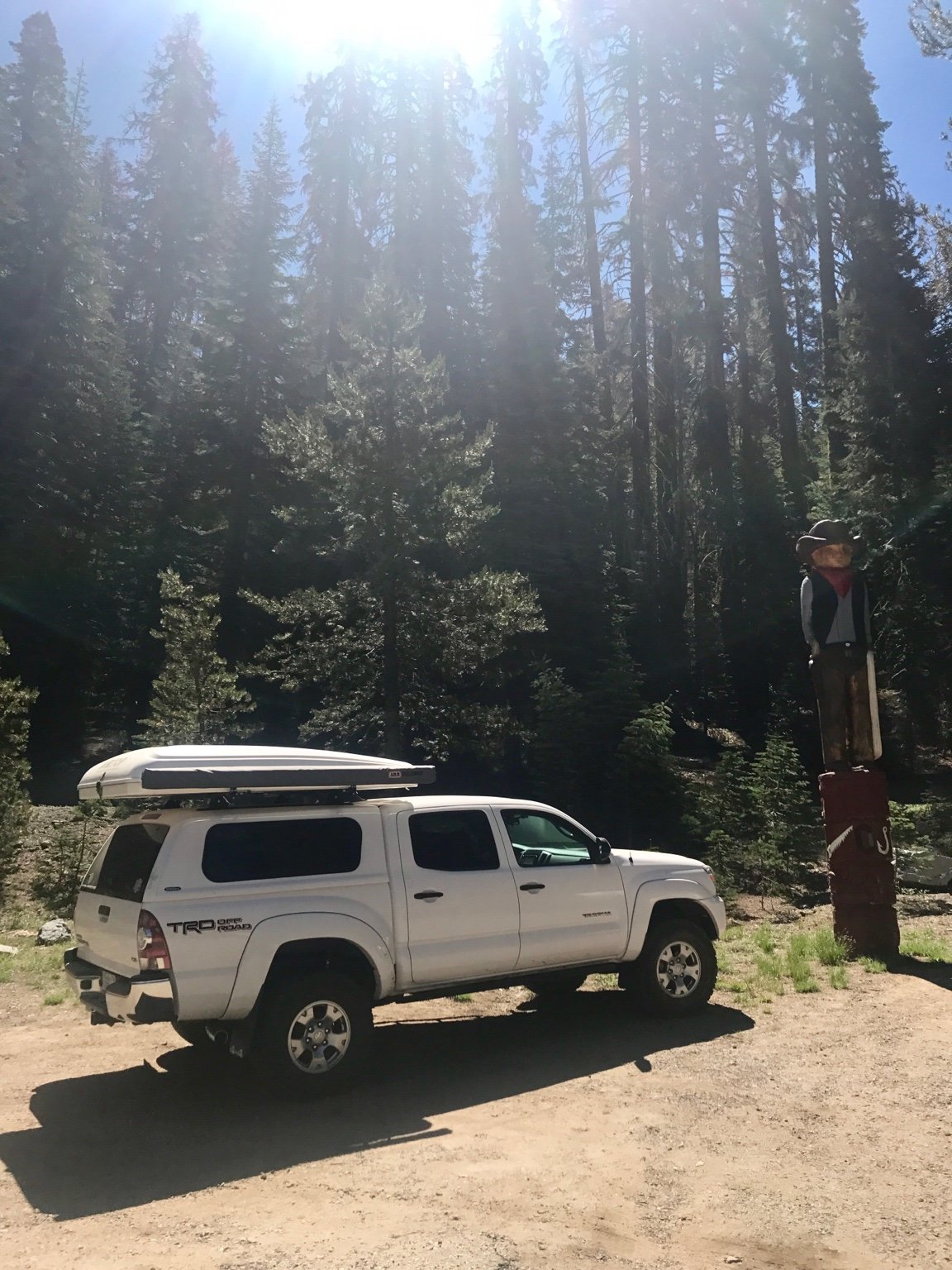

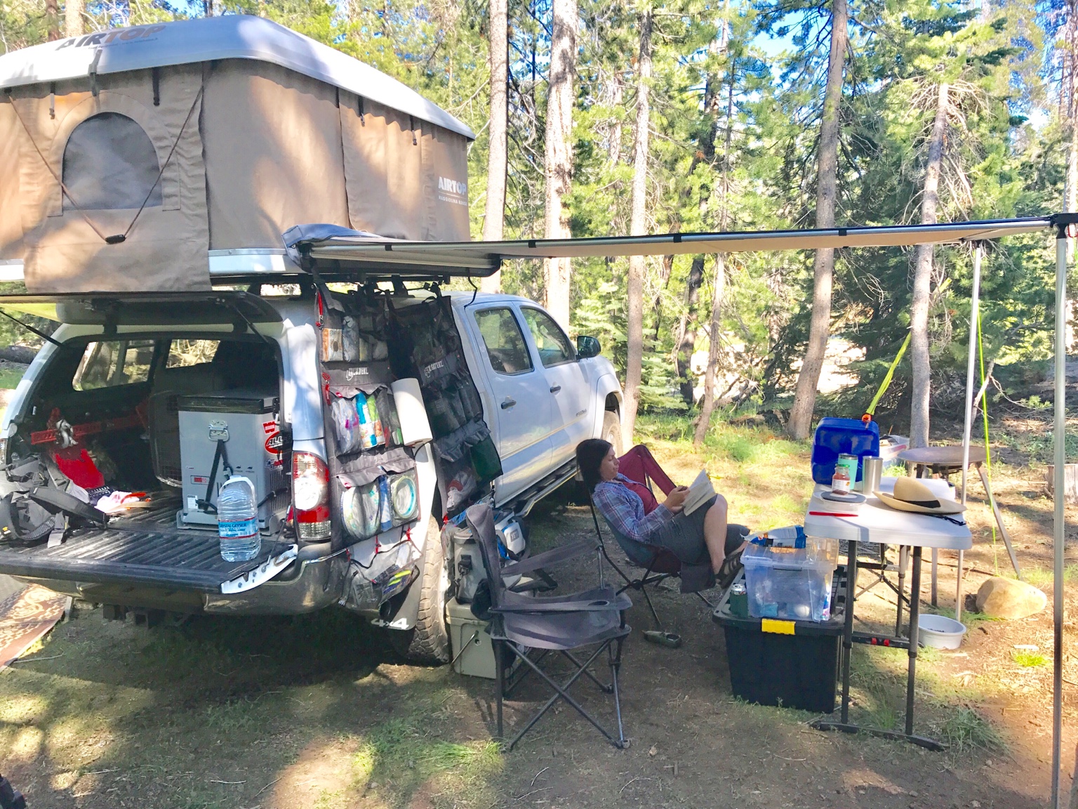

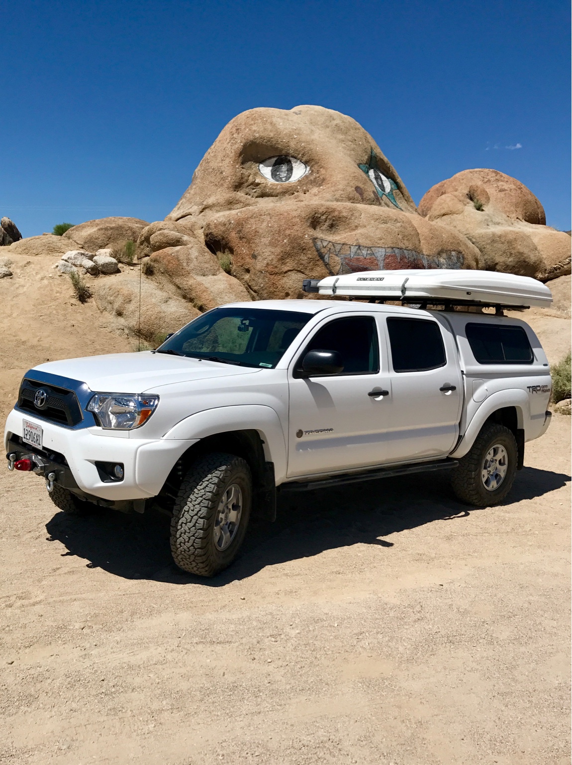

I have a Tepui Autana XL. I have it mounted to a Snugtop camper shell with the sportsman package (ups the dynamic roof carrying weight to 500lbs). I use my truck to commute, and I have a low clearance garage.
For the RTT: I couldn't be happier with it. It's a breeze to set up and tear down. It's actually much easier now that I have it on my shell because I can access the whole circumference of the tent by either opening the back doors, standing on the tires or standing on the rear bumper. I've spent years either sleeping in the bed of trucks or pitching a tent (insert jr high giggle here). Now with the RTT, I get a really comfortable nights sleep and also feel all high and mighty (pun intended) like sleeping on the ground is for peasants.
Mounting the RTT: I did my research prior to buying and I knew what it would take. I had a customized shell made with a thicker roof and Yakima racks pre-installed. I don't use the Yakima racks to hold the tent, but I do use the mounting rails to hold my custom built rack. Here it is:
It's made out of two pieces of 1-5/8" that mount directly to the Yakima rails, and three 13/16" for the cross bars. I used the 1-5/8" to help clear my shark fin. This whole build was two sticks of 13/16" and one stick of 1-5/8". With hardware and paint it cost around $60.
