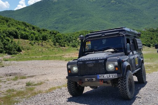

My roll cage is powder coated. At the external part the coating is partially flaking off. The cage is made of steel tube of high strength CrMo 4 with a diameter of 45 millimeters (so a bit less than 2 inches) and a wall thickness of 2.5 millimeters.
Since I have made many good experiences with powder coatings (e.g. my rocksliders are mounted for over 200k miles to the rig and the coating is still in top shape) and then there are again other parts where it flakes after a short time, I will prepare the cage this time itself properly, primer and paint. If the result is good, I can be proud of the result and if it is bad, then I am to blame, but I tried it.
I would therefore like to gather experience in this thread on how best to remove a powder coating. Who has some experience with this and would like to share it?

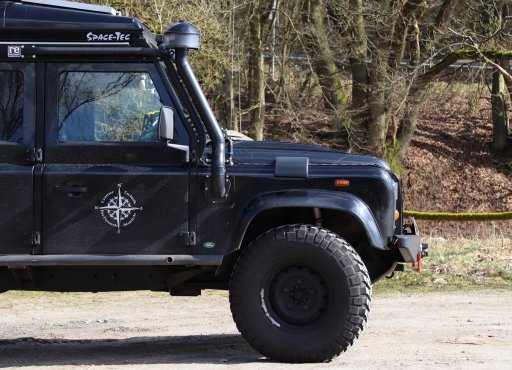

Oha, it's been quite a while. But here it also finally continued.
Ok, currently I do not want to bolt off the rollcage, because I'm too much on the road with the rig - hehe. But now I wanted to fight the rust spots. So, I took advantage of the good weather yesterday and freed all affected areas from the coating, treated with the wire brush and then applied epoxy rust converter.
The result is quite good. At one or the other spot I have to rework again I saw today in bright sunlight, but it will be good. Am satisfied with the result so far. Followed by paint finishing, then it should be good for a while.
